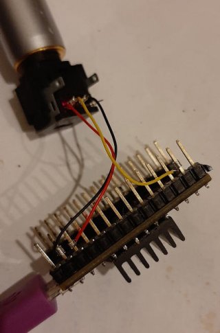

People like pictures, so this shows just how easy it is to get good quality audio from a teensy. Toslink module is a few dollars from ebay.

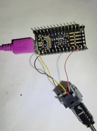

That wiring worked, but wasn't bright enough for some DACs. This works correctly.
