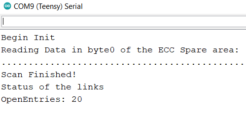

Pushed another update to LittleFS last night before sleep.
Verified that ReadECC and ReadBBLUT (LUT TABLE) was working and added a sketch to the examples folder. Still confused on what exactly has to get done for BB Management. May have to leave that for now.
@defragster - @KurtE - @PaulStoffregen
