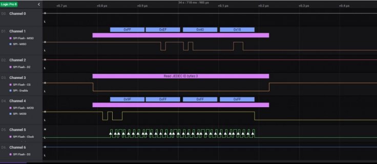

I don't see the JEDEC ID in the lapis-tech.com/.../feram/FEDR45V200A-01.pdf - that will show on first failure to use.
That chip is going to be interesting. Looking at the data sheet I don't see the command to read the ID.
