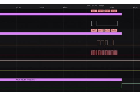

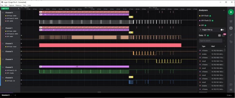

Again you can configure it for normal SPI and not dual/or quad...
And depending on which device family you configure for, it tries to know the different commands to set it into dual or quad and decode from there...
Right now I have both configured as WINBOND with 24 bit addressing.
Here shows with external flash board, LA pins(11, 12, 13, 3, 4, 5, 6) I have two of the SPI Flash analyzers with CS for 5 and 6. I also have an SPI analyzer with pin 5...
Here is startup of MTP-test sketch
zommed in to read ID...
@KurtE = looking good. EF7020 - Winbond W25Q512JV*IM (DTR) from the list of FLASH chips :) Can't wait to see QSPI.
