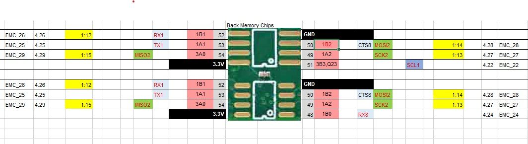

Me too, and then I double checked a few things...
That is, first thought is I need to setup the right SPI pins, so I added:
  SPI2.setMOSI(50);
  SPI2.setMISO(54);
  SPI2.setSCK(49);
  SPI2.begin();
Still does not work. Thought maybe the FlexSPI setup is screwing it up, so I returned as soon as I called that startup still does not work..

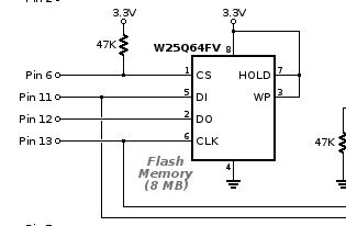

Then I wondered about the other IO pins... And then figured it.... is screwed ...
That is if you look at pins assigned to SPI2, for those bottom Pins, you see:
And now for example if you look at the schematic for the flashmemory, this case from the Propshield you will see:
If you compare correctly 51 is correct for Pin 1 to memory chip.
Now look at 49 which is logical pin2... It shows up as SCK2, where as on the chip it is DO... I.e. they don't align.
Wonder why IMXRT would setup the pins for FlexSPI which has LPSPI not to have the pins match up.
Unless I am missing something. I already rerang out my pins on my T4.1 with castellated adapter and the pins match what I expected. I may try jumpering from T4.1 SPI2 pins to prop shield and see if they work.
Update to my SPI2 message above. I used jumpers from SPI2 pins on my extended T4.1 board to the appropriate pins on the Propshield and
//  pinMode(13, OUTPUT);
//  digitalWrite(13, HIGH);
  SPI.begin();
  while (!Serial) ; // wait
  Serial.println("LittleFS Test"); delay(5);
//  if (!myfs.begin(buf, sizeof(buf))) {
  SPI2.setMOSI(50);
  SPI2.setMISO(54);
  SPI2.setSCK(49);
  SPI2.begin();
  if (!myfs.begin(51, SPI2)) {
And it ran:

So I believe my SPI data is correct.

Think I was trying to use SPI2 when I was playing with NAND chip and came to the same conclusion as you.

Well have another update to the my JVSIM test sketch.
Added
  pinMode(6, INPUT_PULLUP);
to setup after looking at the propshield schematic and the serialflash sketch and guess what - it is now working:

Good thing to keep in mind going forward. Now I don't have to solder up another flash chip :)
