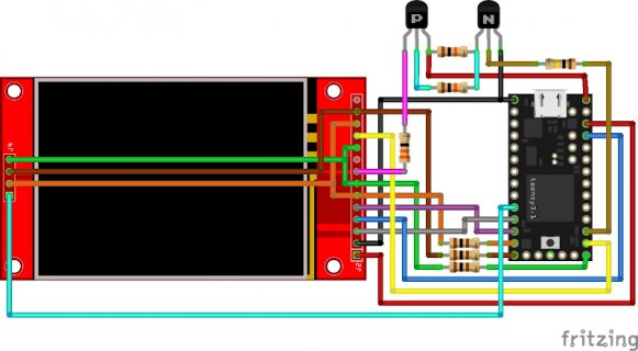

My hardware is an ILI9341 with XPT2046 touchscreen. I purchased it last year so it's listing is expired but an ebay search for "2.8'' TFT LCD Display Touch Panel SPI Serial Port Module ILI9341 SPI 5V/3.3V" should present similar units.
In my project I am using the Audio Shield, so the SPI is connected using the alternate SPI pins and is sharing with an 8MB serial flash on the audio shield. The screen is using ILI9341_t3n and XPT2046_Touchscreen Teensy libraries for the back end. LittleVGL can also access the drives, so I want the SerialFlash and SD libraries as well. The start of my code includes these.
LittleVGL can be obtained through Arduino's Library Manager. I think XPT2046_Touchscreen is included with Teensyduino. There is a hacked version of the ILI9341_t3n library that includes a new function to give LittleVGL DMA to the screen for a substantial performance boost at the cost of some SPI bus sharing synchronisation trickery. This hack is optional, and is only set up for Teensy 3.6 right now, download here https://github.com/prickle/ILI9341_t3n
Touch and screen are both sharing the SPI bus. Pins are set up as follows in code, in actual fact I disconnected TFT_MISO to prevent it interfering with touch. As you can see my backlight circuit is active high. There is also an encoder knob.
//TFT Pin assignments
#define TFT_DC 20
#define TFT_CS 21
#define TFT_RST 255 // 255 = unused, connect to 3.3V
#define TFT_MOSI 7
#define TFT_MISO 12
#define TFT_SCLK 14
#define BACKLIGHT 2
#define BACKLIGHT_ON digitalWrite(BACKLIGHT, HIGH)
#define BACKLIGHT_OFF digitalWrite(BACKLIGHT, LOW)
//Touch Screen Pin assignments
#define TOUCH_IRQ 5
#define TOUCH_CS 10
//Encoder Pin assignments
#define ENC_1 28
#define ENC_2 35
#define PUSH 36
