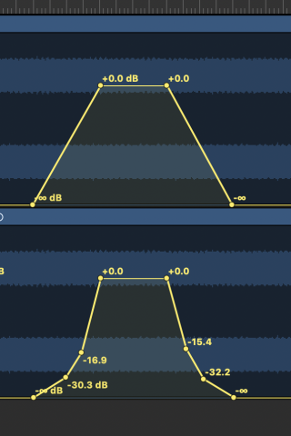

This image kind of illustrates what I am talking about –– I'm looking for the exponential fade in and fade out to be applied to the attack and release of my note.

The reason why I'm 90% sure that this issue isn't from my code is because I get the same issue when testing linear vs exponential fades in a DAW (Logic) with the exact same file.
Here's a screen shot of that:

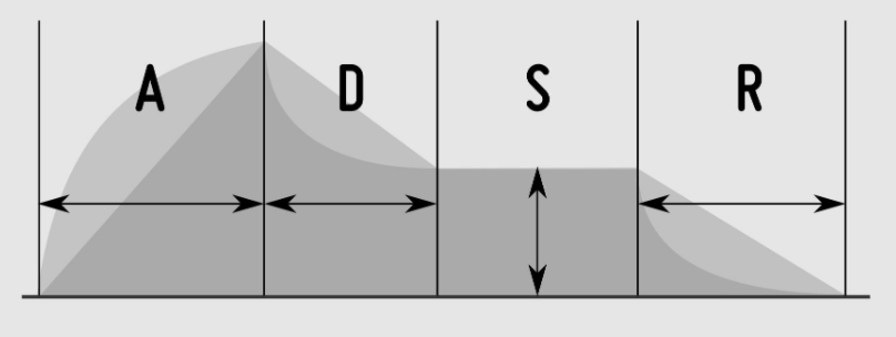

Here's a diagram that visually compares 'exponential ADSR' vs "linear ADSR.':
One isn't right or wrong. In fact, linear is more standard, but exponential accomplishes a smoother fade to silence when using a longer fade time.
Does anyone have any ideas for how I can either modify the envelope or fade to be more exponential? Or accomplish this smoother (log/exponential) fade effect another way?
