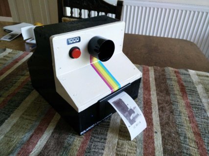

@MichaelMeissner - to report back on the camera. I went with the raspberry pi in the end. This camera is supposed to be a 'clownish' instamatic for a friends wedding where the box will be sitting in the fancy dress area and people take a selfie and it prints to the thermal paper. A digital copy of each photo is kept on the sd card for my friends to keep.

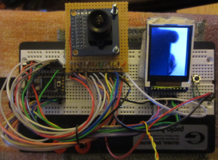

I know this is kind of an old post but I have just been successful interfacing the Teensy 3.1 to the OV7670 Camera Chip and Adafruit 1.8" LCD display and wanted to share what I have learned.IMG_6100.png.
I've made the code available at: craigandheather.net/misc/TeensyCamera.zip
This hardware software combination captures QQVGA (160x120) images in RGB565 format at the rate of about 1.5 images/second.
You are free to use my code anyway you want but if you do something interesting with it, let me know.
