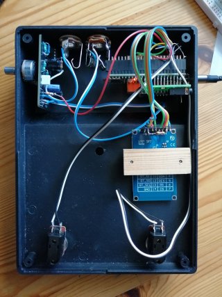

In my setup I use power from USB. This means that there is a connection of digital GND to the PC here.

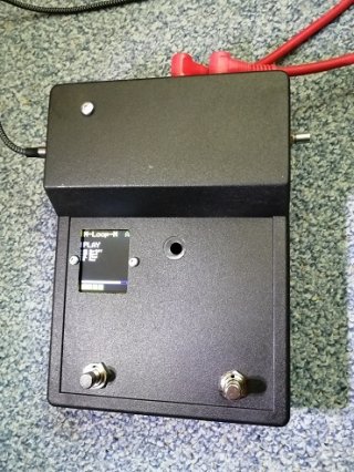

User interface is done via ST7735 1.8" TFT display and just two foot switches. (I did a bore for a rot encoder into my enclosure, to prepare future possibilities....)

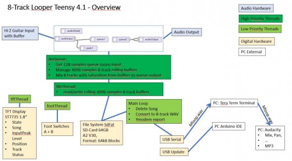

The AudioLibrary Setup is very straight forward.
ADC -> (Peak Detect + Queue1)
Queue2 -> DAC
So there are 2 audio queues. One is used to sample audio into the track. The tracks are summed into the second one to be played.
It holds all track data in one file using 5 64k buffers. It is essential to use a fast SD-card "A2 V30": Sandisk Extreme A2 V30. (64GB)
(I have learned, that wear of the SD card is handled by the controller inside the card.)
The SD-card is formatted to use 64k block size instead of 128k.
File handling is done by the sketch, not by the audio library, which is said not to support ExFAT.
64k Buffers 0 and 1 always hold the start of the loop to be able to switch to the start instantly. No need to read these from the SD-card.
Buffers 2...4 are used rolling: ReadSD - Work - WriteSD
The looper works with the threads library. It's time slices are cut down to only 10 microseconds via "threads.setSliceMicros(10);", time critical threads are set to use 10 slices for high priority.
" int idQueue= threads.addThread(doQueue); // 5
threads.setTimeSlice(idQueue, 10);"
The threads library uses a timer to interrupt whatever is done at the moment including library code.
footThread: User Interface
tftThread: User Interface
doQueue: Read and write the audio queues. Handle the 64k rolling buffers. Mix active tracks by addition plus soft saturation. Fast fade in and fade out at the restart of the loop to reduce "plopp" noise.
fileThread: Read and write 64k rolling buffers to/from the work file on SD-card
Communication between the threads works via global variables.

Attached, there are two pictures of the setup in an enclosure. It is rather large, as I love to have opportunities for additions. Unfortunately I did not find a fine metal low cost enclosure with 2 hights, so this is not shielded. On the other hand, wrapping the setup in aluminium foil did not improve SNR, so no harm done.
