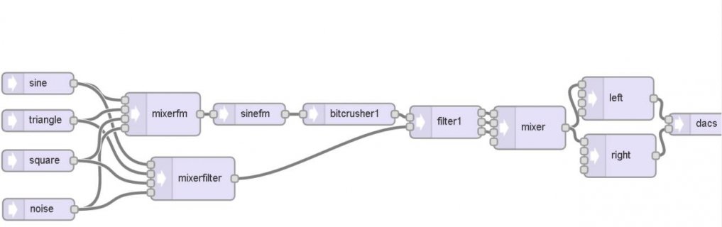

Hello,
my nunchuck/Ps2keyboard synth is pretty well advanced... But I have a little issue on my filter (Chamberlin), when it's set above 16000hz and resonance under 1.05 the synth produce a loud white noise (with some "fm" sound when getting in).
All my other stuffs work great, here is my patch:
abstract of serialmonitor:
AudioMemoryUsageMax() every 5 seconds return me (255) everytime... and AudioMemoryUsage() within 60-230
I'm a musician doing "noise" and experimental music, so it's not a big issue for me but I would to understand what's happen
Perhaps I was too greedy...Proc = 12.12 (55.81), Mem = 101 (255)
Proc = 12.16 (55.86), Mem = 168 (255)
Proc = 12.10 (55.86), Mem = 235 (255)
Proc = 12.11 (55.86), Mem = 47 (255)
Proc = 12.08 (55.86), Mem = 114 (255)
Proc = 12.08 (55.86), Mem = 182 (255)
Proc = 12.10 (55.86), Mem = 249 (255)
full code:
