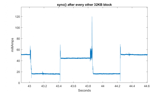

While working on a project to build a low-power data logger using a Teensy3.6, I discovered something a bit counter-intuitive. I found that calling the sync() function after writing a block of data to the output file reduced the overall power drain by a factor of three! This is counter-intuitive because I thought that the sync() function would require an extra write to the SD card after updating the file directory. Apparently, the power reduction occurs because something in the sync() function puts the SD card into a low-power mode—which doesn’t automatically occur at the end of a block write.

Here are the results of the tests:
Algorithm mA with no sync() mA with sync()
Queue 24mHz 44.66 *(1)
Ping-Pong 32KB 24Mhz 43.60 14.31
Ping-Pong 64KB 24Mhz 43.94 13.91
Queue 48MHz 52.48 *(1)
Ping-Pong 32KB 48MHz 52.65 18.94
Ping-Pong 64KB 48MHz 51.75 18.36
*(1) Calling sync() after every file write (at 10KHz) is a BAD IDEA! It causes queue overruns
and other problems

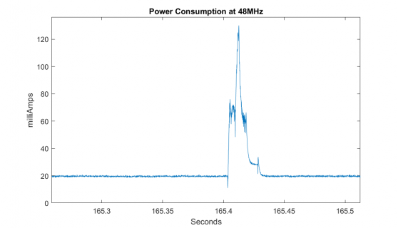

* Thanks to the time spent with the CPU asleep, boosting the CPU speed from 24 to 48MHz only adds about 5mA to the current drain. This would add lots more clock cycles for things like digital filters, more channels, etc.— but at the cost of more current drain.
* USB connections get pretty flaky at 24MHz. Quite often, neither my PC host program nor the Arduino Serial Monitor will connect to the Teensy. Connections are never a problem at 48MHz.

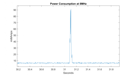

* Switching to a slower, 8GB SanDisk card, reduced average power consumption in the PP tests by about 1mA, but peak power drain was cut by more than a factor of two: from about 140mA to about 55mA. I suspect the reduction is due to lower erase currents for the smaller erase blocks on the 8GB card. Building an efficient power supply for a logger that has a 10:1 variation in current drain can be challenging. (Think large capacitors and quick transient response.)
* A modified test which eliminated all use of the USB serial port reduced power drain in the PP tests by about another 1-2mA. (I don’t have a USB cable long enough to connect to a logger moored at 100m depth in the equatorial Pacific!) I suspect that turning off other peripherals might have similar effects.
