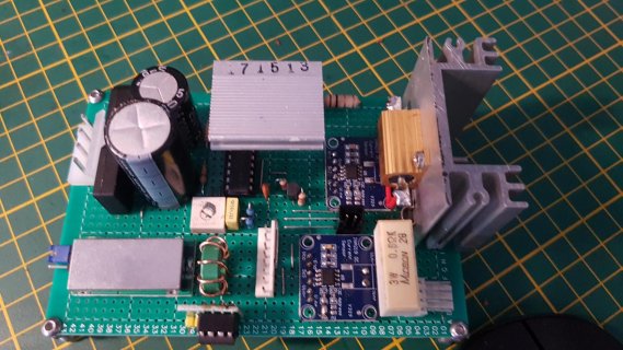

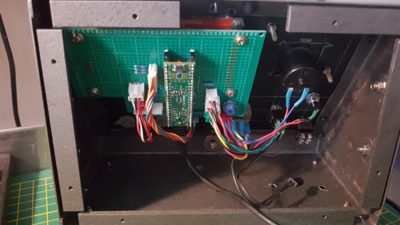

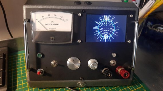

Very nice, thanks @KurtE that is indeed a drop-in replacement for the unit I'm using, changing the pinout is no issue because that part of my prototype is point-to-point flyleads. I have bought one, I will be able to continue development using the 9488 then swap out the hardware and drivers when it arrives in a few weeks.
