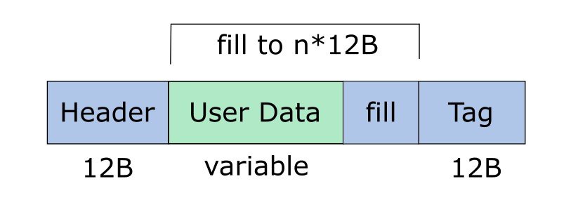

Paul didn't set up the default pool, so sm_malloc_stats won't give correct values. You need to use the pool version:
  while (!Serial);
  int* ptr = (int*)extmem_malloc(5 * sizeof(int));
  size_t total, totalUser, free;
  int blocks;
  sm_malloc_stats_pool(&extmem_smalloc_pool, &total, &totalUser, &free, &blocks);
  Serial.printf(
      "Total used:       %u bytes\n"
      "Total user vars:  %u bytes\n"
      "Free space:       %.4f MB\n"
      "Allocated blocks: %u\n\n",
      total, totalUser, free / 1024 / 1024.0f, blocks);
Which prints the correct values:
Total used:       48 bytes
Total user vars:  20 bytes
Free space:       15.9990 MB
Allocated blocks: 1
Each allocated chunk of memory is contained in one block. The block starts with a 12byte header, followed by the user data + some fill bytes and a closing 12byte tag.
The fill bytes will fill up the user data to n*12 bytes. The returned pointer points to the beginning of the user data of course. If you want to get a pointer to the block you can use the macro USER_TO_HEADER as shown in #11.
Hope that answers your question somehow?

Maybe we should have a way to pad allocations to 32-byte cache row boundaries?
From the readme:
Searches are done by shifting a header-wide pointer across the pool.
Allocated block is found by testing each possible header for validity.
So, as it is now the block size needs to be a multiple of he header size. If I understand the readme correctly the header has 4bytes for the block size, 4bytes for the size of the user memory and 4bytes for a hash -> My gut feeling is that 32bit blocks will need some major rewriting of the library. Might be interesting of course...
Indeed, seems likely we'll eventually have to make substantial changes to smalloc, or replace it with some other memory management scheme. For now (version 1.54) this is probably good enough. Long-term, we probably do need alignment to cache rows to avoid thorny issues when people try to use DMA on their allocated memory.
