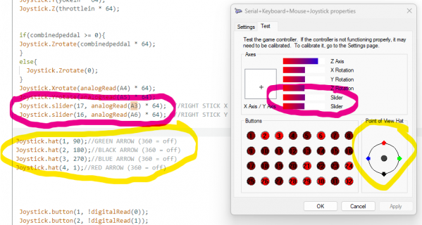

hello everyone, i tried joystick set to 64 (extreme) and i use pointy joysticktest.exe to test but in raw mode it not response only in directx input mode, im try to using 10sliders, please advise thankyou so much
i dont understand why my slider is not mapping it correctly

I solved my issue, I was unaware that number 17 corresponded to slider 0, makes no sense to me :/
Thank you! I have been pulling my hair out for days! I finally buckled down and just started reading EVERY comment on this post. How to fix slider 0 by using slider 17 :( Now I gotta figure out slider 1!
EDIT:
Slider 0 = 17
Slider 1 = 16
  Joystick.slider(17, 512 * 64);
  Joystick.slider(16, 128 * 64);
And I got some code working on the HATS!
