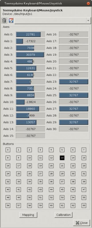

Many axis joystick
I tried with Windows 7 and fiddled with the report descriptor until Windows recognized it as a joystick.
This one has 128 buttons, 6 axes, 17 sliders, and 4 hat switches.
Nice work Paul, I wondered last night when I look at the descriptor if it was the usage min and max windows didn't like.
It's working here now but..
Only showing 1 hat under DirectX, but interestingly it is showing 128 buttons and 23 axis!
I just need to figure out how to access the extra sliders.
Regards,
Les
After another quick play it seems I am not getting any data for hat or sliders through DirectX.
Regards,
Les
Are any gamers or flight sim people following this thread? Can anyone test and see if those programs can access the many extra sliders?
Fixed Hats by tweaking descriptor...

Tried the test program just now, version 091. It crashes on startup on my Win 7 test machine. :(
Edit: I tried this joystick test and also this one. Neither is able to recognize this huge joystick.
Edit again: I retested on Linux. "jstest-gtk /dev/input/js1" is able to recognize it, but only 64 buttons, and of course the 4 hats show up as the last 8 axes.
(click for full size)
