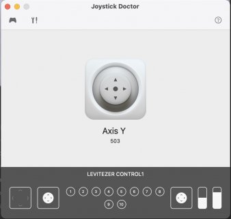

The problem is exactly that I can delete usb_desc.c from the teensy4 directory and it builds (and joystick works). The usb_desc.h on the same directory can not be deleted and the edits on that are effective.
Here is a video the usb_desc.c has been renamed usb_desc_d.c there is no usb_desc.c
The joystick name has been edited on the usb_desc.h that is on the same directory, so the directory should be correct.
https://vimeo.com/555199322
So the question is, where should I edit the stuff that is on usb_desc.c so that it is effective?
Note renaming a usb_desc.c to usb_desc_d.c
Makes 0 differences to the build. You could call it foo.c and it would still build. The build system will compile every .c .cpp file within that directory.
If you actually setup your system to do verbose builds, you would see that it built usb_desc_d.c and as such satisfied any external references needed.
I do not understand. That is very strange, but seems to be the case. I removed the file form the directory, and still compiles just fine.
But after restarting Arduino environment does not compile any more, so clearly it notice now that the file is missing.
But this is also pretty frustrating, do I always need to restart the Arduino environment after changing the usb_desc.c?
and also the problem maybe was that I did a usb_desc_copy.c before editing the usb_desc.c and left it on the same directory, so maybe it used that instead of the usb_desc.c... This does not feel smart. Really, is it not caring about the file names at all, but good to know, I could not have figured that out without help, thanks Kurt.
verbose build, what is that and why is it not default.
And hey, it worked. actually what I edited before provided the wanted result, only 10 buttons shown

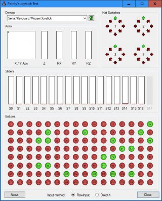

Hi all, I'm building a Sim control panel.
Just wondering if the post36 attached files are still valid? I don't seem to be able to download them? Maybe it's just me being a noob on this forum.
Edit: I was viewing the forum in mobile mode! All downloads fine when viewing in full site. Lol
Sorry I have not played much with the many axis... But I would not recommend using the files in the posting #36. They are going on 8 years old, and the the files that these would replace have had some significant changes in that time frame.
It has been awhile since I built using the setup, as to mainly test for other things.
But I think the better route is to edit the current source files.
Most of this I believe is now controlled by simply editing the usb_desc.h (either the teensy3 or the teensy4 version)
Then depending on which USB type you wish to use like "Keyboard + Mouse + Joystick" that gives you: #elif defined(USB_HID)
You will find a line like:
  #define JOYSTICK_SIZE         12	//  12 = normal, 64 = extreme joystick
Which in my file is about line 289
Change it to 64 and I believe this drive the other files that were in the zip file to use the extreme joystick.

this is my first post here, but I have been reading this forum for several months now.
I am building (for years) an F-16 cockpit with all switches and knobs "functional", that is,
they are all wired. As simulation software I plan to use BMS.
To make wiring not too messy, I use (for the Left Console) 3 Arduino Nano on a self-developed
"carrier board" using MCP23017 to expand to 64 digital inputs and 64 digital outputs.
I chose the MCP23017 for I2C connection, because I needed the SPI connection for the
RF24L01 transceiver in the 2.4 GHz band. These Arduino Nanos are called "slaves", and they
connect via the RF24L01s to the Teensy 4.1. The T4.1 also has an RF24L01. Works really perfect.
Using the standard Teensy 4.1 Joystick configuration, I get 32 DX buttons and 6 sliders,
but for my application that is not enough. I tested this configuration and the 32 DX buttons
all work fine and the axes/sliders also work as expected.
So, I changed JOYSTICK_SIZE to 64 (to be sure all 4 entries) in usb_desc.h
Using Pointy's great JoystickTest.exe (version 0.9.2), I see 128 DX buttons, and they all work!!
Also, I *see* 6 axes and 17 sliders, but none of them work, they remain 0.
I did not change the setting of all potmeters, and did not switch power. Only edited usb_desc.h
and compiled the T4.1 code again. And now I am stuck ...
I thought that the JOYSTICK_SIZE to 64 in usb_dec.h was all it takes, but maybe I am wrong.
Is there more to be changed to get the sliders working ?
BTW, not switching power, only changing usb-desc.h to the original (JOYSTICK_SIZE 12) and
compiling the T4.1 sketch shows working sliders again ...
Thanks for reading!

Just some more info.
After I edited usb_desc.h (and changed all 4 JOYSTICK_SIZE definitions to 64), I terminated the Arduino IDE, and then started the IDE again, and subsequently compiled my program again. I am sure that the changes are "accepted", because Pointy's JoystickTest.exe (v0.9.2) shows all the sliders.
And I selected "RawInput" in JoystickTest.exe. All DX buttons work, but all sliders and axes just remain 0.
Hoping Kurt or Pointy will read this.
