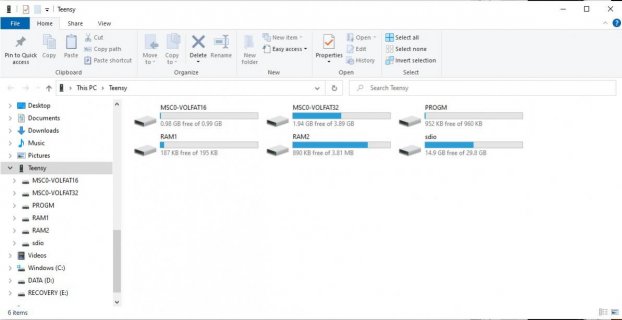

Starting to play with MTP again...
First off: Integration question, probably for @PaulStoffregen.
In an SdFat-beta project issue conversation with Bill about supporting the changes above, he verified that the dates and times for files for the SDFat stuff is already defined and is actually in our SDFat library in the build...
So question is, should some of this be peculated up into the FS File class? Personally I think it should as again I would see cases where files change over MTP (or elsewhere) and if I were using things like configuration files, I might want to know the file changed...
