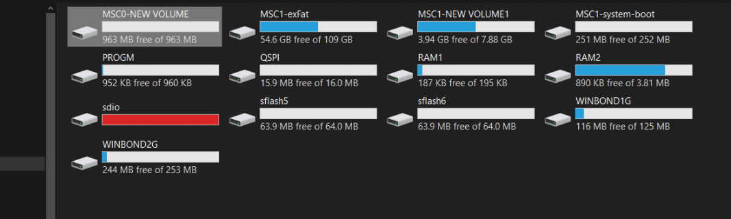

Waiting up to 5 seconds for USB drive 1
^^Waiting up to 5 seconds for USB drive 2
^Initialize USB drive...UsbBase::mscBegin called 20002620 1 1
^^^^ After usbDriveBegin
PFsVolume::begin(20002170)
^^^^^USB drive 1 is present.
msc # Partition Table
part,boot,bgnCHS[3],type,endCHS[3],start,length
[B]exFAT: 1,0,0x20,0x21,0x0,0x7,0xFE,0xFF,0xFF,2048,234436608[/B]
pt_#0: 2,0,0x0,0x0,0x0,0x0,0x0,0x0,0x0,0,0
pt_#0: 3,0,0x0,0x0,0x0,0x0,0x0,0x0,0x0,0,0
pt_#0: 4,0,0x0,0x0,0x0,0x0,0x0,0x0,0x0,0,0
Partition 0 valid:1
Partition 1 valid:0
Partition 2 valid:0
Partition 3 valid:0
0:>> ExFat: Volume name:(120GB_Ext) Partition Total Size:120026300416 Used:197394432 time us: 84126
Free Clusters: API: 914222 by CB:0 time us: 0
A_00001.dat
A_00002.dat
A_00003.dat
A_00004.dat
A_00005.dat
A_00006.dat
A_00007.dat
Initialize USB drive...UsbBase::mscBegin called 20002f20 1 1
PFsVolume::begin(2000260c)
USB drive 2 is present.
[B]FAT32: 1,80,0x20,0x21,0x0,0xC,0xFE,0xFF,0xFF,2048,67108864
FAT32: 2,0,0xFE,0xFF,0xFF,0xC,0xFE,0xFF,0xFF,67110912,54128640[/B]
Partition 0 valid:1
Partition 1 valid:1
Partition 2 valid:0
Partition 3 valid:0
0:>> Fat32: Volume name:(B )###FatPartition::freeClusterCount: FT:32 start:10244 todo:1048194
m_sectorsPerCluster:64
m_clusterSectorMask:63
m_sectorsPerClusterShift:6
m_fatType:32
m_rootDirEntryCount:0
m_allocSearchStart:1
m_sectorsPerFat:8190
m_dataStartSector:26624
m_fatStartSector:10244
m_lastCluster:1048193
m_rootDirStart:2
m_bytesPerSector:512
Partition Total Size:34347155456 Used:28836429824 time us: 3071623
Free Clusters: API: 168174 by CB:168174 time us: 512490
efi/
bootmgr
boot/
bootmgr.efi
sources/
reagent.xml
Mejii_MBAM.txt
HWMonitor_x64.exe
hwmonitorw.ini
MyPhoneExplorer/
arduino_b1.9_B27/
TyComm/
tCode/
UserBack.bat
smonteith/
casa/
irs2017/
TUN-320 Win 10 Driver/
1:>> Fat32: Volume name:(64G_PT#2)###FatPartition::freeClusterCount: FT:32 start:67117264 todo:1690498
m_sectorsPerCluster:32
m_clusterSectorMask:31
m_sectorsPerClusterShift:5
m_fatType:32
m_sectorsPerFat:13208
m_dataStartSector:67143680
m_fatStartSector:67117264
m_lastCluster:1690497
m_rootDirStart:2
Partition Total Size:27697086464 Used:65536 time us: 4953373
Free Clusters: API: 1690492 by CB:1690492 time us: 826116
FPartTwo.txt
Initialize SD card...SD card is present.
[B]FAT32: 1,0,0x20,0x21,0x0,0xC,0xFE,0xFF,0xFF,2048,16777216
exFAT: 2,0,0xFE,0xFF,0xFF,0x7,0xFE,0xFF,0xFF,16779264,33554432
FAT32: 3,0,0xFE,0xFF,0xFF,0xC,0xFE,0xFF,0xFF,50333696,67108864
[U]pt_#15: 4,0,0xFE,0xFF,0xFF,0xF,0xFE,0xFF,0xFF,117442560,126834688[/U][/B]
PFsVolume::begin(200047f0)
>> Fat32: Volume name:(SD1_8GB_AD)###FatPartition::freeClusterCount: FT:32 start:10262 todo:1047042
m_sectorsPerCluster:16
m_clusterSectorMask:15
m_sectorsPerClusterShift:4
m_fatType:32
m_sectorsPerFat:8181
m_fatStartSector:10262
m_lastCluster:1047041
m_rootDirStart:2
Partition Total Size:8577351680 Used:40960 time us: 187475
SD1_8GB_AD.txt
SD1_8GB_AD/
>> ExFat: Volume name:(SD2_16GB_AD) Partition Total Size:17175674880 Used:262144 time us: 3686
SD2_16GB_AD/
SD2_16GB_AD.txt
>> Fat32: Volume name:(SD3_32GB_AD)###FatPartition::freeClusterCount: FT:32 start:50341892 todo:1048194
m_fatType:32
m_dataStartSector:50358272
m_fatStartSector:50341892
m_rootDirStart:2
Partition Total Size:34347155456 Used:163840 time us: 187637
SD3_32GB_AD/
SD3_32GB_AD.txt
done...
Press any key to run again
