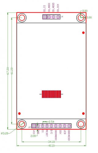

Thought I might hack up another shield for the Teensy LC(or 3.1) and color display and support for AX servos and some other stuff...
May try to size it about the size of the Teensy display (http://www.pjrc.com/store/display_ili9341.html).
Looking at the sizes of the display in the drawing:
Wondering a few things, which for the most part I can pretty closely measure from the new (currently spare) one that arrived yesterday.
Things like, the two sets of IO pins are centered horizontally in the display. I am also guessing they are offset about .1" from top and bottom.
So about 62.12mm(or about 2.45")
Has anyone tried using the SDCard on this display with a Teensy? I am pretty sure that the 4 SPI IO pins associated with this are not connected to the other SPI pins.
Again not yet if I will make it and/or what other things it might have. I would for sure at a minimum have the IO pins brought out. Maybe at least some with power pins and the like.

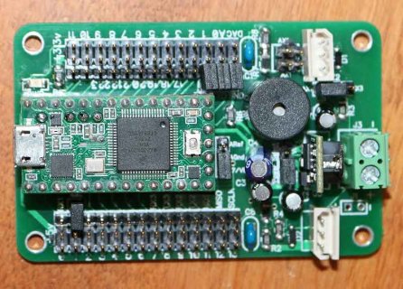

quick update.
Currently the new board I am playing with no longer is setup for TFT display although one could be hooked up. Instead I wanted a smaller/simpler version of my other boards, that has sounds, and AX servos, plus 3 pin breakouts for the IO pins. I received the fabricated boards from Seeedstudio, and today I assembled one. How much of each board that I will assemble depends on what I am going to use it for.
I expect a lot of the time, may be very minimal, as I may use them as AX servo controller to hook up to Linux boards. In that case will use USB power. so don't need other power connectors, VR, some CAPS... Also experimenting using more minimal RC circuit for speaker.
Just starting to play, I took a shortcut today and bypassed where I would use multimeter to do some minimal checks (like shorts) before connecting power. Luckily did not have T3.1 plugged in as I had a solder bridge across the VR from VIN to ground. When I connected the battery it fried the etch... Not sure what else:eek:
I removed the solder bridge. I think there may still be issues if my jumpers are set to take power from VR, but should be OK to test with USB. So will still try to do some testing of it.
Luckily I socketed it, so if board is bad can simply build new one... One thing I did not notice until today, is this T3.1 is missing the actual button part of the program button. So far I have not needed it... May be time to order some more...
