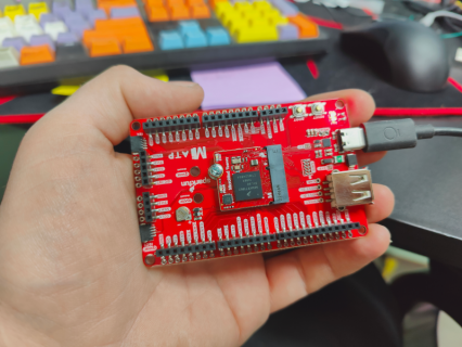

Have you come across the Teensy MicroMod ? https://www.sparkfun.com/products/16402 Not quite as many IO as you propose but is already commercially available off the shelf
I hadn't come across this, thank you for sharing! As long as I can get at least 2 of the canbus's to work this should be perfect for my use cases. I can't believe I didn't come across this in my searching. I think I'll order up a few of these and see how it goes!
Oh man this is PERFECT, exactly what I was hoping for. SO glad I don't have to design my own and can just buy these!
