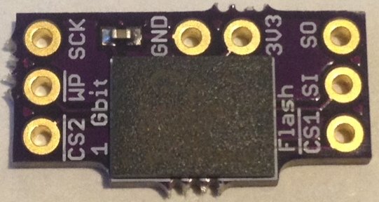

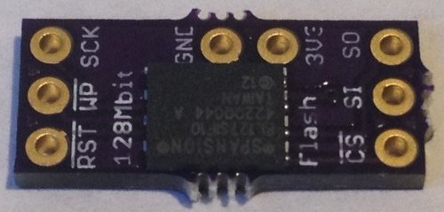

The chips yes, if they are deselected with cs (and that's the reason for the needed pullups on cs! - "default" deselect) they are invisible on the bus.BTW, what does one do if pins 10 - 13 are required for another peripheral like an I2S mic or radio? Can these SPI flash chips be multiplexed with other peripherals?
I expected that these Spansion chips would have internal pullups on CS like they do on RESET and WP; I didn't add any external pullup resistors.
If I de-select any SPI add-on device by holding CS HIGH (default) on all of them, then can I use the SPI port for the other Kinetis-on-chip functions like I2S, which also (in the simplest configuration) use Teensy 3.1 pins 11, 12, and 13?
Yes, there are internal pullups on RESET and WP but not CS. This can be handled in software as in the dorkbot tutorial so for now the testing of these add-on boards can continue, but I agree good practice would be to add a 0402 4K7 pullup resistor on CS as I have already added a bypass cap on VIN.

#if USE_SPANSION_FL512S || USE_SPANSION_FL01G
/* Spansion Corp. flash SPI FL512S SPI Flash memory or the FL01G which is two FL512S in one package - NOTE!!! two chip selects needed for the FL01G.
