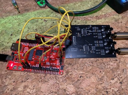

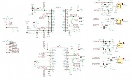

I want to use the MicroMod Teensy on an audio project. I've got it in the ATP carrier at the moment but planning a custom carrier with codecs for 4 output channel sound (only need 1 input).
Plan was to use 2x WM8731 as I have experience with them and have a few of them to hand but I see the MicroMod format has only one I2S.
Am I right in thinking that without the second I2S that will be difficult or is there a way to work around that or re-assign interfaces the MicroMod?
Fall back plan is to use a CS42448 with the TDM object so not a disaster if it won't work but would prefer the WM8731s if there's a way to make them work.
