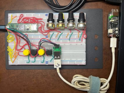

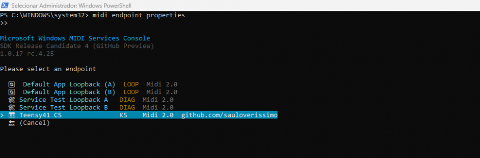

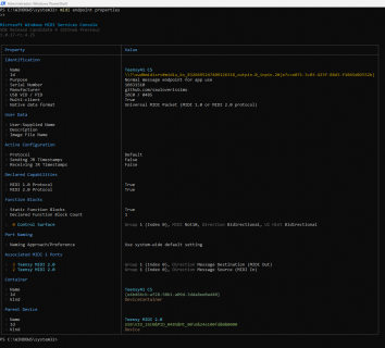

About Teensy examples: I ran a proof of concept of the application
layer in a lib of mine called midi2cpp (sauloverissimo/midi2cpp on
github). It has a Teensy 4.1 sketch (teensy41-midi2.ino) that
shows the full path: UMP Stream identity (Endpoint Discovery,
Function Block), MIDI-CI with Discovery + Profile + 2 Properties,
and a demo loop that fires the MIDI 2.0 repertoire: NoteOn with
32-bit velocity, 32-bit CC, Per-Note Pitch Bend, Per-Note
Controllers, Flex Data (Tempo + Time Signature). It's the
skeleton. Right now I'm working on an adaptation with pot and
switch reading, to close exactly the use case you described.
Today it runs on top of the cores fork as experimental overrides;
if the conversation with Paul lands on a different path, it
adapts. But I built it driven by the desire to see Teensy
operating in MIDI 2.0, more as an experiment than anything.
I agree 100% with you about the products. I cited Roland A-88MKII
and Korg Keystage only because Paul set that premise back in 2020.
They check the box, but you're right: real hobbyist work calls for
something more accessible.

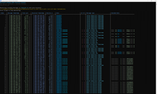

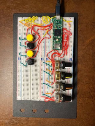

Edit: Follow-up: the adaptation I mentioned is up.
teensy41-control-surface in midi2cpp covers exactly what you
described: 4 pots on A0..A3 sending 32-bit CC (CC1 Modulation,
CC74 Brightness, CC71 Resonance, CC91 Reverb Send), 4 switches
on D2..D5 sending NoteOn/Off (C4..D#4), and any UMP received from
the host decoded line by line to Serial at 115200: NoteOn/Off,
CC, PitchBend, ChannelPressure, Program, Per-Note PitchBend,
Flex Data Set Tempo + Set Time Signature.
~175 LOC sketch, MIDI-CI left out to keep it simple. EMA smoothing
+ deadband on pots, millis debounce on switches, 12-bit ADC
expanded to 32-bit by replicating the MSB so the full range
reaches MIDI 2.0 receivers. Hardware-validated on Teensy 4.1
today against Linux ALSA (/dev/snd/umpC*D0).
Repo: github -> sauloverissimo/midi2cpp, examples/teensy41-control-surface.
README has pin map, wiring, build command, and what each block
does.

Just trying the control surface example, and it doesn't compile:
Arduino: 1.8.19 (Windows 10), TD: 1.59, Board: "Teensy 4.1, Serial, 600 MHz, Faster, US English, 44.1kHz, 128 samples (normal), 2, Off"
C:\Program Files (x86)\Arduino\arduino-builder -dump-prefs -logger=machine -hardware C:\Program Files (x86)\Arduino\hardware -tools C:\Program Files (x86)\Arduino\tools-builder -tools C:\Program Files (x86)\Arduino\hardware\tools\avr -built-in-libraries C:\Program Files (x86)\Arduino\libraries -libraries D:\Jonathan\Teensy\libraries -fqbn=teensy:avr:teensy41:usb=serial,speed=600,opt=o2std,keys=en-us,audiorate=44,audioblocksize=normal,USBchannelcount=2,gdb=off -ide-version=10819 -build-path C:\Users\Admin\AppData\Local\Temp\arduino_build_870774 -warnings=none -build-cache C:\Users\Admin\AppData\Local\Temp\arduino_cache_476675 -verbose D:\Jonathan\Teensy\libraries\midi2cpp\examples\teensy41-control-surface\teensy41-control-surface.ino
C:\Program Files (x86)\Arduino\arduino-builder -compile -logger=machine -hardware C:\Program Files (x86)\Arduino\hardware -tools C:\Program Files (x86)\Arduino\tools-builder -tools C:\Program Files (x86)\Arduino\hardware\tools\avr -built-in-libraries C:\Program Files (x86)\Arduino\libraries -libraries D:\Jonathan\Teensy\libraries -fqbn=teensy:avr:teensy41:usb=serial,speed=600,opt=o2std,keys=en-us,audiorate=44,audioblocksize=normal,USBchannelcount=2,gdb=off -ide-version=10819 -build-path C:\Users\Admin\AppData\Local\Temp\arduino_build_870774 -warnings=none -build-cache C:\Users\Admin\AppData\Local\Temp\arduino_cache_476675 -verbose D:\Jonathan\Teensy\libraries\midi2cpp\examples\teensy41-control-surface\teensy41-control-surface.ino
Using board 'teensy41' from platform in folder: C:\Program Files (x86)\Arduino\hardware\teensy\avr
Using core 'teensy4' from platform in folder: C:\Program Files (x86)\Arduino\hardware\teensy\avr
Detecting libraries used...
"C:\\Program Files (x86)\\Arduino\\hardware\\teensy/../tools/arm/bin/arm-none-eabi-g++" -E -CC -x c++ -w -g -Wall -ffunction-sections -fdata-sections -nostdlib -std=gnu++17 -fno-exceptions -fpermissive -fno-rtti -fno-threadsafe-statics -felide-constructors -Wno-error=narrowing -mthumb -mcpu=cortex-m7 -mfloat-abi=hard -mfpu=fpv5-d16 -D__IMXRT1062__ -DTEENSYDUINO=159 -DARDUINO=10819 -DARDUINO_TEENSY41 -DF_CPU=600000000 -DUSB_SERIAL -DLAYOUT_US_ENGLISH "-IC:\\Program Files (x86)\\Arduino\\hardware\\teensy\\avr\\cores\\teensy4" "C:\\Users\\Admin\\AppData\\Local\\Temp\\arduino_build_870774\\sketch\\teensy41-control-surface.ino.cpp" -o nul
Alternatives for midi2cpp.h: [midi2cpp@0.4.1]
ResolveLibrary(midi2cpp.h)
  -> candidates: [midi2cpp@0.4.1]
"C:\\Program Files (x86)\\Arduino\\hardware\\teensy/../tools/arm/bin/arm-none-eabi-g++" -E -CC -x c++ -w -g -Wall -ffunction-sections -fdata-sections -nostdlib -std=gnu++17 -fno-exceptions -fpermissive -fno-rtti -fno-threadsafe-statics -felide-constructors -Wno-error=narrowing -mthumb -mcpu=cortex-m7 -mfloat-abi=hard -mfpu=fpv5-d16 -D__IMXRT1062__ -DTEENSYDUINO=159 -DARDUINO=10819 -DARDUINO_TEENSY41 -DF_CPU=600000000 -DUSB_SERIAL -DLAYOUT_US_ENGLISH "-IC:\\Program Files (x86)\\Arduino\\hardware\\teensy\\avr\\cores\\teensy4" "-ID:\\Jonathan\\Teensy\\libraries\\midi2cpp\\src" "C:\\Users\\Admin\\AppData\\Local\\Temp\\arduino_build_870774\\sketch\\teensy41-control-surface.ino.cpp" -o nul
Alternatives for midi2.h: []
ResolveLibrary(midi2.h)In file included from D:\Jonathan\Teensy\libraries\midi2cpp\examples\teensy41-control-surface\src\teensy41_control_surface.h:24,
  -> candidates: []
                 from D:\Jonathan\Teensy\libraries\midi2cpp\examples\teensy41-control-surface\teensy41-control-surface.ino:22:
D:\Jonathan\Teensy\libraries\midi2cpp\src/midi2cpp.h:27:10: fatal error: midi2.h: No such file or directory
   27 | #include "midi2.h"
compilation terminated.
Using library midi2cpp at version 0.4.1 in folder: D:\Jonathan\Teensy\libraries\midi2cpp
Error compiling for board Teensy 4.1.
Loving the level of documentation you've put into this, by the way! I can't pretend I've read it all yet, though...
OK, found it - there's a second library it's dependent on, which you didn't mention in the example header comment. Compiles ... now to test ...
Thanks for catching that. Fixed.
The README mentions Teensyduino 1.60+ as the
minimum, and you're on 1.59. Switch USB Type to MIDI2 in Tools before upload.
Let me know how it goes.
Very brief testing done, all seems to be working as advertised! I only tested the CCs, but given they're good I can see no reason why buttons / notes won't work too.
I know it looks as if I'm using Teensyduino 1.59, but actually it's just a horrible mash-up of various versions including PRs that haven't even made it to a beta, let alone a release...
Yes ... I had to add those menu entries to my boards.local.txt so they appeared in the Tools menu ... is that in a ReadMe somewhere? Again, I have that pretty heavily modified already, so I can test the multi-channel USB, so that was straightforward for me to do - maybe not so much for others? My changes are:

Hello, my friends.
Following up on the USB device descriptor work from the past few
weeks, here is the host side: USB MIDI 2.0 on the Teensy 4.1 host
port.
Same spirit as the cores fork: minimal changes, transport only.
The USBHost_t36 fork (+110 LOC, branch feature/midi2-host-base on
my github) walks the descriptors in claim(), selects Alternate
Setting 1 via SET_INTERFACE when the device exposes UMP, and adds
readUMP() / writeUMP() / umpMode() to MIDIDeviceBase. MIDIDevice
and MIDIDevice_BigBuffer inherit it with no source changes, and
MIDI 1.0 devices keep working through the usual path (alt 0).
There is a ready-to-run example in midi2cpp: teensy41-host-midi2.
Plug a MIDI 2.0 device into the host port, the sketch discovers
its identity (Endpoint Name via UMP Stream + MIDI-CI Discovery)
and prints every decoded message to Serial. The sketch also has a
stress mode: the same zero-loss methodology we used to validate
the TinyUSB, midi2cpp and ESP32_Host_MIDI. Result on the
Teensy 4.1: 144,693 UMPs received over 9 min 43 s, one full
16-bit sequence wrap-around, zero loss.
The cores fork also got a spec conformance refinement this week
(Group Terminal Block default protocol + SET_INTERFACE bounds).
If anyone wants to test it with their MIDI 2.0 gear, or review
the descriptor walk, feedback is very welcome.
@h4yn0nnym0u5e
@PaulStoffregen
