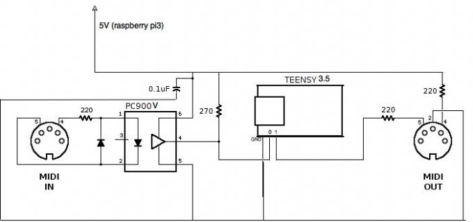

Hello everyone, I'm Makoto.
I tried to make the MIDI controller by Teensy 3.5
(refer to this URL:https://www.pjrc.com/teensy/td_libs_MIDI.html).
I wrote the code, connect MIDI out to MIDI in on Moog synthesizer,
Although the system wasn't worked.
The circuit is as like as My_Circuit.jpg(attached).
Thanks for the help!
Makoto Takahashi

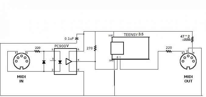

Should I change the circuit as like as MIDI.jpg?

Which resistors did you use? 3.3V signals require different resistors (mentioned on the web page). 220 ohms usually only works for 5V signals.
Thanks for your reply,Paul.
I overlooked the web's description and used 220 ohms.
Should I change the resistor of 220 ohms on pin 4 of MIDIout to two 47 ohm resistors?
I'm sorry for the late reply. I will not touch Teensy for a while for some purpose……, but I will try it.
I did MIDIout with reference to the same URL. But it didn't work. Is it because the resistance of 270 ohms was connected to 5 V instead of 3.3 V?
Thanks Paul and Revalogics!!
I succeeded in running the system.
I changed the resistor of 220 ohms on pin 4 and pin 5 of MIDIout to 100 ohm resistors.
