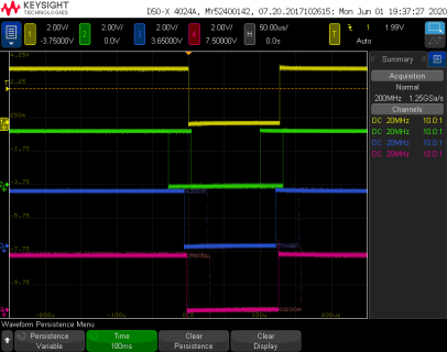

If I have one interrupt for all 8 UARTs, and each one sends a MIDI clock message one after the other like it's written in the code, then am I right in assuming the delay between UART 1 and UART 8 would only be 13ns? (1/600,000,000)*8
No, probably not a valid assumption. The exact timing behavior will depend on many fine details of the internal design of those UARTs, which NXP doesn't publish. But we do know some things. The UARTs run from 24 MHz, and they divide clock clock down to a multiple of the baud rate. We also know the code to write data into the UART buffers, and the interrupt code to transfer bytes between those buffers and the UART's FIFO also takes many instructions.
While these are all much more than 13 ns, they are very short compared to the 320,000 ns required to transmit a single byte at 31250 baud.
The only way to really know is the measure. So I set up a quick test, just for you (and anyone else who later files this thread) to check. The short answer is +/- 1 bit time.

My oscilloscope only has 4 channels, so I connected to TX1, TX2, TX7, TX8, so we can see the first 2 and the last 2 outputs.
The next result is the timing varies by approx +/- 1 bit time, which is about 32 us at 31250 baud. Other very minor differences can also be seen. Here's a screen grab from the scope:
A seemingly strange result is Serial7 output happens before Serial1, even though it was written later. I believe what's happening here is the UARTs are actually running at some frequency, perhaps 500 kHz, which is 16 times the baud rate, though I didn't do anything to dig deeper in the actual settings used. So writes that happen very quickly in software are probably waiting until the next 2 us clock on each UART, and all 8 of them are not running perfectly in sync with each other. In this test, it looks like Serial7 happens to be getting it's divided clock slightly ahead of the others.
But this picture doesn't tell the whole story. While the waveforms line up like this most of the time, occasionally the flicker or jump quite a bit. Since I can't capture video of the on-screen movement, I'll turn on the screen persistence to try to show you the image.
Here you can see the green waveform often starts 30 us before the yellow, and the blue and red occasionally (but rarely) start about 30 us later. Remember, the scope is triggering on the yellow waveform, which may also be occasionally different, which would show up as all 3 shifting.
So while there's a lot of fine details in the timing, the net result is the 8 outputs usually come out very close to each other, but occasionally the timing can vary by about 1 bit time at 31250 baud, or about 32 us.
