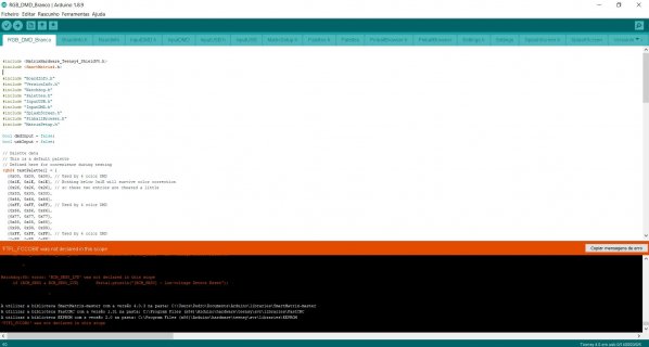

thanks , I didn't read the migration file; I removed the library I was using for Teensy 3.5, and installed the new library to use on Teensy 4.0
errors in arduino program

Watchdog:62: error: 'RCM_SRS0_WDOG' was not declared in this scope
if (RCM_SRS0 & RCM_SRS0_WDOG) Serial.println("[RCM_SRS0] - Watchdog(COP) Reset");
Watchdog:63: error: 'RCM_SRS0' was not declared in this scope
if (RCM_SRS0 & RCM_SRS0_LOC) Serial.println("[RCM_SRS0] - Loss of External Clock Reset");
Watchdog:63: error: 'RCM_SRS0_LOC' was not declared in this scope
Watchdog:64: error: 'RCM_SRS0' was not declared in this scope
if (RCM_SRS0 & RCM_SRS0_LOL) Serial.println("[RCM_SRS0] - Loss of Lock in PLL Reset");
Watchdog:64: error: 'RCM_SRS0_LOL' was not declared in this scope
Watchdog:65: error: 'RCM_SRS0' was not declared in this scope
if (RCM_SRS0 & RCM_SRS0_LVD) Serial.println("[RCM_SRS0] - Low-voltage Detect Reset");
Watchdog:65: error: 'RCM_SRS0_LVD' was not declared in this scope
A utilizar a biblioteca SmartMatrix-master com a versão 4.0.3 na pasta: C:\Users\Pedro\Documents\Arduino\libraries\SmartMatrix-master
A utilizar a biblioteca FastCRC com a versão 1.31 na pasta: C:\Program Files (x86)\Arduino\hardware\teensy\avr\libraries\FastCRC
A utilizar a biblioteca EEPROM com a versão 2.0 na pasta: C:\Program Files (x86)\Arduino\hardware\teensy\avr\libraries\EEPROM
'FTFL_FCCOB0' was not declared in this scope
You may be using the correct SmartMatrix library for a T4, but your own code is still expecting a T3.
For example in Boardinfo.ino you have:
 Read the MAC address
 http://forum.pjrc.com/threads/91-teensy-3-MAC-address
 To understand what's going on here, see
 "Kinetis Peripheral Module Quick Reference" page 85 and
 "K20 Sub-Family Reference Manual" page 548.
void readMAC(uint8_t word, uint8_t *mac, uint8_t offset) {
  noInterrupts();         // Disable interrupts
  FTFL_FCCOB0 = 0x41;     // Selects the READONCE command
  FTFL_FCCOB1 = word;     // Read the given word of read once area
The comment indicates that the code is written for Teensy 3. You will have to find the equivalent function for a Teensy 4.
Similarly, the errors caused by this statement in the configureInputDMD function in InputDMD.ino:
  CORE_PIN10_CONFIG = PORT_PCR_MUX(2) | PORT_PCR_PE | PORT_PCR_PS;
are because it is specific to the Teensy 3 architecture.
You'll have to figure out how to replace these, and the other errors in Watchdog.ino, with code that works on the Teensy 4.
Pete
Thank you, because I am already using the SmartMatrix 4 library.
The question is what kind of changes I will have to make to the code
Yes, the problem isn't with the Smartmatrix library.
The problem is that the original code written by Eli Curtz (i.e. all the code in your RGB_DMD_Branco directory) is written specifically for the Teensy 3.2 and uses code which directly accesses the hardware registers of the T3.2.
It will not be an easy task to convert this code to work with the Teensy 4.0 or 4.1.
Pete
