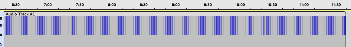

Below is my implementation (it simply places full scale 32767 spikes at each PPS into the otherwise silent audio stream ). I haven't yet implemented h4yn0nnym0u5e's clock drift correction suggestion (my T4 clock is over by only 48 ppm, ie two samples too short each second: not problematic. Next assignment: sniffing the USB data to evaluate latency between the hardware interrupt and the actual spike position with my DSLogic).
It seems to work but from time to time there's a miss (around 11 misses in this 11 minutes recording):
Is there such a thing as interrupts collision? What if the hardware 1 PPS arrives more or less at the same time as the update() call? Should I block interrupts somewhere in my code?

Yes, the Cortex M7 used by Teensy has what's termed "nested" interrupts, which means that a higher priority interrupt can interrupt a lower-priority one that's already in progress.
In this case, the pin interrupt is (I think) at level 128, whereas the audio interrupt is level 208; by the weird system used by ARM, this means the pin interrupt is higher priority... You need to think very carefully about the possible sequences and overlaps to ensure PPS pulses aren't lost, and the audio update doesn't use partial / stale information, and loop() doesn't overwrite information not yet consumed by the audio update.
To give one example, what happens if the audio update occurs between the following two lines of loop()? And what happens if these lines are executed when blocks_to_go_before_PPS hasn't counted to zero?
C++:
punch1.blocks_to_go_before_PPS = whole_blocks;
punch1.samples_to_go_before_PPS = remaining_samples;

And if an interrupt is temporarily blocked (eg with AudioNoInterrupts() for the Audio Library) , is it lost, or simply postponed?
Maybe I could suspend hardware interrupts only (is this possible? found this), since the 1 PPS signal stays up for a long time (more than 10 ms IIRC).
For the most part a masked interrupt will not be lost, just delayed for (up to) however long it takes your code between the disable/enable calls to run. The accepted wisdom is thus to keep such code as short as possible, and never make calls to library functions while interrupts are masked (or indeed from inside an ISR).
The duration of your PPS signal is irrelevant, as you’ve rightly got it triggered by the rising edge. Once triggered it will remain pending until your ISR is serviced, which will not necessarily be immediately, if a higher priority interrupt is executing or interrupts are masked. If bad code results in it remaining pending for over a second, then of course you will have lost a PPS pulse…
To mask all interrupts you’d use __disable_irq(), and __enable_irq() to unmask them. AudioNoInterrupts() is the correct choice if all you care about is masking the audio update.
