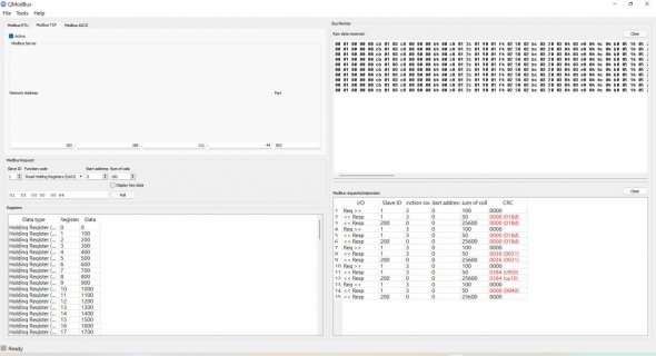

What I need is the Modbus portion instead of the webserver. I also need a way to divine the appropriate memory address for the data tag (encoder count integer value represented by "mCurPosValue1" in the above program) to interface with the HMI visualization program.
Any help would be greatly appreciated!

I have gotten the code to work successfully for modbus communication over tcp/ip however there is a lot of latency from the request from Qmodbusmaster before I can make another request without throwing an error from the teensy 4.1
The response from the teensy states address 200 (when it is really 1) with erroneous data (25600 coils)

Hello,
Did you find a solution to the modbus delay?
I am facing similar issues with ModbusTCP. It works but after a few requests, it kind of locks until I can make another request.
Thank you.
there is no latency Problem on this side, not visible to me...
the problem is from the other side on how many request they startet
but i have a other Problem, only one client can connect. how is it possible to Change?
i think my problem is neer this part
 EthernetClient client = EthServer.available();
  if (client.connected()) {
    modbusTCPServer.accept(client);
    // poll for Modbus TCP requests, while client connected
    modbusTCPServer.poll();
    // Serial.print("poll");
