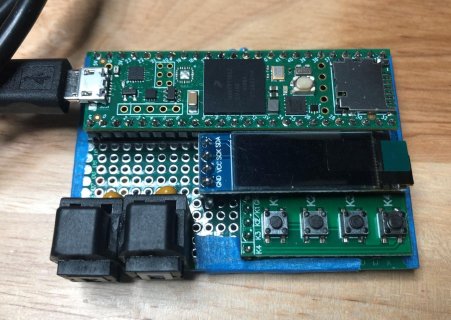

OK, I am pretty much all done with pulling this project together and the Teensy platform, Paul, and this forum have been just outstanding in me getting started and going with this project. I have Arduino experience with other micro-controllers but this was my first go with the Teensy platform and I am impressed.
Currently I am using the Teensy 4.1, running both a SPDIF3 input and a SPDIF3 output through the audio library that contains a mix of existing and custom effects. The project also contains an I2C display and a set of pushbuttons for interaction with the system as well as EEPROM storage of configuration values for retention while powered off.
I would still like to add low-power mode/stand-by when no input signal is present, with auto-wake up on a signal being received. I have to dig into that some.
I still have a lot to learn/explore with this platform but I don't think that is too bad for ~5 weeks hobbying around with all of this.
The only real "open" issue I have is (and others more knowledgeable than I may say it does not matter) the AsyncAudioInputSPDIF3 input is working fine but when I use AudioInputSPDIF3 in I get distortion/interference on the output even if I disable all of my manipulations. My goal with this project was to create a device that sits between an audio digital source and a DAC allowing me to manipulate the digital data. I [maybe falsely] assumed that AudioInputSPDIF3 would be preferable due to the resampling done by AsyncAudioInputSPDIF3 thus making the input data less "pure" to the original data from the source. Is this an invalid assumption?
I have been switching between the AudioInputSPDIF3 and AsyncAudioInputSPDIF3 objects. Again AudioInputSPDIF3 results in noticeable distortion and AsyncAudioInputSPDIF3 does not. Am I being overly concerned about the resampling? Is there a way (if it is even needed) to configure the resampling to minimize input changes?
Thanks much!
P.S. added a photo of the current "prototype"...

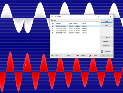

  • I'm using a Teensy 3.2 as a signal generator, so the input is at 44117Hz sample rate which should be a good test
  • You must run the Serial Plotter to get the sketch running: it shows a snapshot of the waveforms every second
Note that the Audio System Design Tool does state in red text that "[The AudioInputSPDIF3] input is incompatible with most other inputs and outputs which run at a speed controlled by Teensy's internal sample rate."
In order to avoid further random guesswork, it would help if you post simple code and wiring to allow someone else to reproduce the issue. If the process of simplifying the code results in a solution, please tell us what it was - future generations will thank you (at least in their minds...).
EDIT: OK, I do have very occasional glitches using synchronous S/PDIF: every 14.57s or so, it appears...

After a bit of modification and testing, I've put in a pull request to make AudioInputSPDIF3 and AudioOutputSPDIF3 mutually compatible, so long as they're the only audio I/O objects in a system. The PR includes updates to the design tool so the I/O clashes (should) show up correctly, and the info pane says a bit more about what should work together.
I suspect this won't be pulled in any time soon, as Paul has a fair bit of work on Teensyduino 1.58 by the looks of it, so you may need to grab the changes directly if you want to try them out.
Going back to your post #7, as far as I can tell AsyncAudioInputSPDIF3 works very well, though I've not tested it thoroughly (not really qualified to do so!). "Obviously" it's better to avoid resampling if you can, and I think it does take a chunk of CPU time to do it which I'm sure you can put to use making the effects even better...
