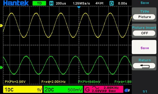

For a verification test I:
- Set the Hantek signal generator to 2KHz @ 2.4v
- Sent the Hantek signal to the A2S.
- The A2S to the S2A.
Scoped the initial signal from the Hantek and the results of the S2A. The initial signal was a sine wave 2KHz @ 2.5v. The scoped signal from the S2A was 2KHz @ 1v, it looked perfect with no artifacts, 2KHz in and 2KHz out.

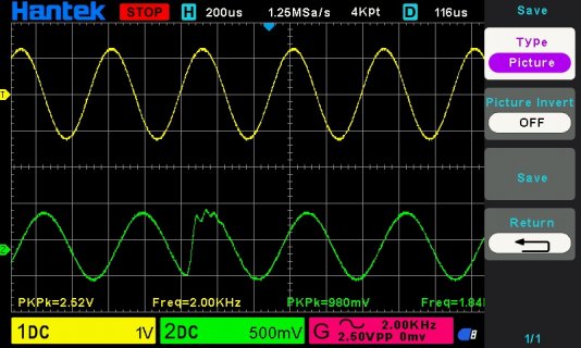

For the base test, I inserted the T4.1 prototype board between the A2S and the S2A (with an additional optical cable). For this test:
- I updated to your latest audio library (5 min ago).
- Recompiled and loaded a "SPDIF pass through" app (shown below) and confirmed your library was being used (via the compiler msgs).
- Connected Hantek signal generator (sine wave @ 2KHz/2,5v) to A2S
- A2S to T4.1 SPDIF in.
- T4,1 SPDIF out to S2A.
- Scoped initial signal to A2S and signal out of the S2A.
The 2KHz/2.5v in becomes 1.84KHz out (mostly, sometimes jumping to 2KHz every so often) at 1v and with occasional glitches in the signal.

baseline image:
glitchy image:
Excellent, we have progress! As you say, something's wonky with test setup #1, but it's likely to be fixable.
Can you post links to your S/PDIF transmitter and receiver parts (on your Teensy setup, not A2S or S2A), and drawings of the wiring that works and doesn't? Also, use the various sample rate functions to report the incoming S/PDIF rate as seen by spdif3in, and the audio library update rate.
A quick calculation tells me that 2kHz * 44100 / 48000 = 1.8375kHz, so something is not running at the right rate... but it should be with your pass-through sketch and my revised library, especially as it runs OK on setup #2.
