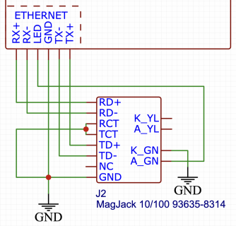

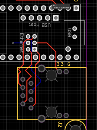

Hello everyone,
I'm having difficulties getting the Molex MagJack 10/100 93635-8314 (https://www.molex.com/en-us/products/part-detail-pdf/936358314?display=pdf) working with Teensy 4.1 connecting it directly to the ethernet pins.
I have attached my schematic and boardview.
Any help and advice would be HUGELY appreciated please because I'm losing my mind trying to figure this out.
Probably is likely due to RCT and TCT shorted to GND.
Cut this wire and add a 0.1uF capacitor.

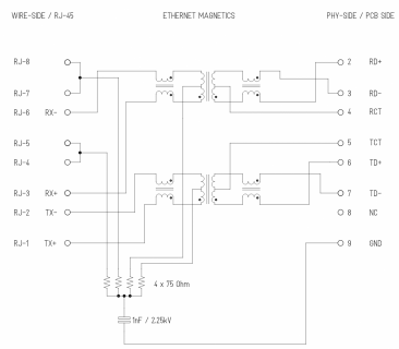

Here is the schematic from the ethernet kit (scroll down to "Technical Details") for comparison.
Looking at the schematic of the MagJack, I thought I don't need a capacitor there because it's built into the MagJack - I have attached the schmatic from the Molex documentation.
Looks like Paul’s schematic goes left to right, and the Molex one from right to left. So you do need to fit the capacitor…
You absolutely do need the 0.1uF capacitor.
That capacitor inside the magjack is for a different purpose. If you look at the datasheets for the Cetus and LinkPP magjacks (again, scroll down to "Technical Details" on the ethernet kit page), you'll see they also have that 1nF capacitor.

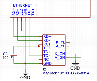

Actually originally I had a 100nF capacitor there, I just removed it after it didn't work thinking that was the problem.
So it didn't work with that either :(
Something else must also be wrong. But difficult to spot such a problem without seeing more clearly.

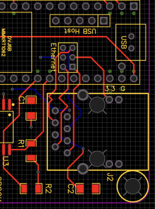

Can you show up the PCB layout (version with the 0.1uF capacitor) and a photo of the actual bare PCB and a soldered PCB?

Please find the original boardview attached and I'll try to get you some photos shortly.
Top plane that the Teensy sits on is ground, bottom plane is 3.3v.
I spent a few minutes looking at your PCB layout and the Molex datasheet. Really looks like it ought to work, assuming a ground plane connects to the other side of C2.
Thanks very much Paul!!
Yes, top side is ground where C2's right side connects to.
