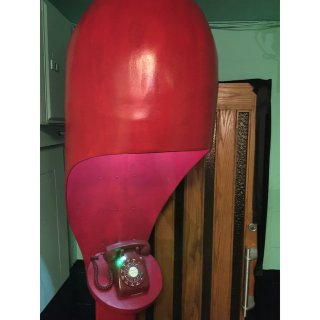

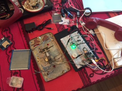

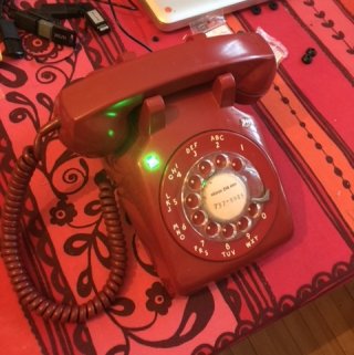

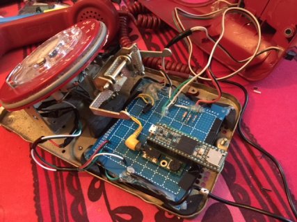

Hi everyone,
I’m in the last phase of a project: a stand-alone old rotary phone that acts as a direct voice message answer machine when you lift the line. I use the Teensy 3.6 with the Audio Shield. All messages are recorded on an MicroSD card.
It work very well, but to get some improvements and realism, it would be great that the user could hear his voice while leaving his message. Without this, it looks that he’s not “live” and maybe his message wasn’t recorded. This audio feedback (not a Larsen, but a witness) is very important, based on some users comments I had with my proto.
I thought it was a special mixer configurations, or maybe just a “physical” thing to do with the electronics on the board.
What do you think?
Thanks for your help.
Just want to add that I will post my code! I’m just presently on my cellphone and can’t access to the files on my computer.
I also have photos of the project, but the forum interface give me errors when I try to upload them.
Ok, here's my code, as you can see, it's a blend of multiple codes I found, thanks to generous predecessor coders:

And here's some photos...

Wow, that's a really nice looking build.
Would it be ok with you if we showed this on the website, when you've got it finished?

Oh! Sure Paul, I’d be honored.
I have photos for pretty all steps and tonight we will mount the phone to its cabin which is have a funny ‘70 design.

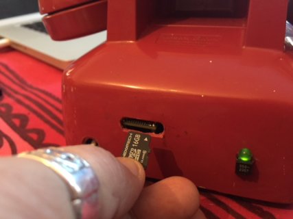

Hi Paul,
Here's the latest version of the code and other photos including when it was installed yesterday. It still not finished though, many amelioration to do, but public had started to try the proto and they loved the concept..
Thanks for your interest :)
