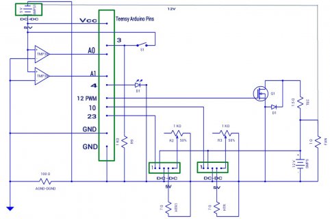

I have been working on a temperature regulated thermoelectric cooling system to cool the CMOS sensor of a Canon DSLR camera for astrophotography work.
I'm using aTeensy 2.0 (Teensyduino) to pwm a logic level n-channel mosfet (very low rds on ~1.3milliohms), to switch current through the TEC. EMI has been a significant problem interfering with camera electronics. This is partly solved by bonding the camera chassis and the copper conducting plate fixed to the back of the camera sensor and then connecting to ground.
I resolved the remaining EMI (mosfet switching), with the use of ground planes and voltage planes instead of traditional snubber circuits, which were not at all effective for this application. Separating analog and digital ground sources, as well.

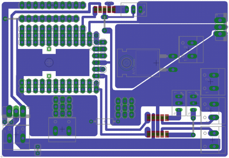

I want to run heating supplies off the same board using 3 switchable and trimmable voltage regulators - 5 pin SIP. These have an on/off logic pin and I want to activate heating at 6 Celcius - Arduino code is no problem. The Eagle CAD PCB attached shows SMD pads overlayed with vias to create holes - this is a hack because there was no part in Eagle, and I have not yet learned how to create parts.
datasheet http://www.ledsales.com.au/pdf/MDC_OKR-T-1.5-W12-C.A01.D5-214787.pdf
I am looking for guidance on how to integrate these switchable voltage regulators into the circuit so that they are controllable. The prototype board is not working and I have damaged one Teensy - there seems to be a feedback problem which is preventing the Teensy USB and the board from operating.
The solution might be a simple matter of isolating the inputs to the voltage regulators with diodes. However before continuing, at risk of breaking another board, I would really appreciate feedback on what I have created here. Another symptom is positive voltage in the analog ground section. I didn't have these issues prior to adding the switchable regulators.
Thank you - looking forward to a response
EDIT: added schematic
