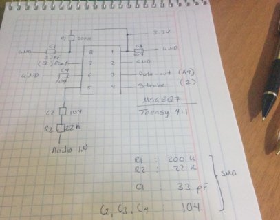

I've been searching many sites looking for a hookup schematic for attaching the MSGEQ7 board to my Teensy 4.1 chip. I can't find any hook up guides.

Did you perhaps see this page?
Looking at the code and the instructions, I don't see any problem why it should not run a Teensy 4.1.
Edit: another useful page.
Paul
PS: you need to power the MSGEQ7 at 3V3, not 5V, otherwise you would kill the T4.1.

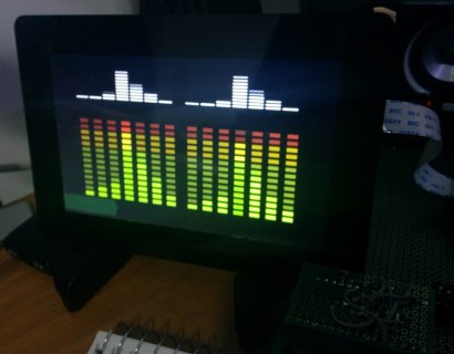

How small is this world! jejeje. I found a couple of those MSGEQ7 chips in DIP8 format. After reviewing many assemblies on the net, I found the most suitable circuit, consider 3 smd 104 capacitors, one of 33 pF, a 200K resistor and a 22K resistor.
