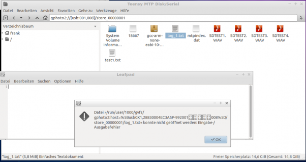

If I try to open the filemanager, it shows nothing - maybe the config I posted above is still not 100% correct.
After disconnect / connect to the Virtual Box Lubuntu, now it shows the files:
But reading the text file does not work.

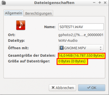

This is interesting, too:
The sizes are wrong.

I found some little problems.
My linux now shows the Teensy MTP. But it crashes if I want to access the files.
Newest observation:
Trying to delete a file, linux throws this errormessage:
test1.txt: Fehler beim Löschen der Datei: -10: Timeout reading from or writing to the port
(error deleting the file)
Nothing but displaying the filelists work so far :)
- new directory: no
- new file: no
- delete file: no
- read file: no
The usb descriptor has a problem (fix is some posts above - not sure if this the absolutely right version ;) )
Edit:
Timeout when creating a folder:
Fehler beim Erstellen des Ordners: -10: Timeout reading from or writing to the port
looks like linux is waiting for a response.

I'm working with your latest version from github.
The errormessages re: timout came from linux. So linux seems to wait for a response.
In the meantime, I tried MTP DISK, (without serial)
Interesting: It does the same, but much faster. If i open a file now, I get a fast reponse (screenshot in a post above "Buffer problem")
Trying to delete still results in a linux timeout, or , new "Error 7, IO Error"
One time, it seemed to delete the file - the icon was removed and nor errormessage. But then i refreshed the window, and the file was still there? So, it appears to me, the the code does not even try to delete the file.
Perhaps it gets the wrong command?
I'm working with the SD-Card.
