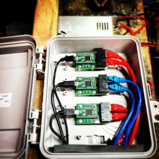

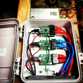

I am driving 24 5m 60 LED/m strips with 3 Teensy 3.1 / OctoWS2811, based off the VideoDisplay sample, with pixel data streamed from an external USB source and one Teensy being the master and driving framesync to the other two. I am powering the Teensy boards via the +5V power supplies used for the LEDs (not USB cable).
My setup looked like this before i started tying the sync signals together:
The SYNC pads of each Teensy need to be tied together, but what about the GND and +5V? When i was doing testing before setting up my rig, i didn't have anything attached to GND, but i'm wondering if those need to all go to the power supply ground, and if so, if they need to be tied together. The +5V on each Teensy is running a separate line to the power supplies.
Sorry, sort of an EE newb.
Thanks,
--matt
