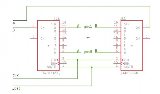

Connect the A/B line to two pins on the Teensy. With the load line you latch the current values of the encoder switches. Then clock in one after the other. If you define all encoders on the same two pins (A/B) you'll get what you want. You can find an example of the polled encoder algorithm here: https://github.com/luni64/PollEncoder

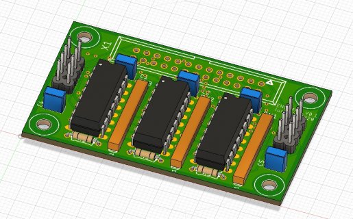

Since I wanted to try multiplexed encoders for quite some time and I wanted to test the new Eagle version anyway, I did a quick 74HC165 based test board. (Eagle files and Gerbers on github (https://github.com/luni64/PollEncoder) if somebody wants to try). It can multiplex up to 8 encoders + 8 switches. The board can be daisy chained to extend the number of encoders. Don't know yet if it works I'll post results when I got the boards.
On the Teensy side it requires 5 pins (A/B SW CLK and LOAD)
  • ENC_MPX_V0.1.pdf
So I downloaded eagle to have a look at this. Wow, it's different than from 10 years ago. Also it's autodesk now...
Anyway.
Two questions:
1. Why the pull downs on the encoders?
2. How about voltage level? I don't know much about encoders, but they are labeled "5V" mostly. Does this work with non 5v tolerant teensys?
Yes, looks a bit different :) I'm using Eagle for about 35 years now, good thing is that despite the GUI, the underling workflow, the key shortcuts etc didn't really change and is still very effective. They improved the manual routing capabilities the last years, the autorouter is as bad as it always was, but for this board I simply was to lazy and let the autorouter do whatever it wanted to do.
The usual mechanical encoders are simply switches with a common gnd or vcc. You need to either pull them up or down. If you connect them directly to the teensy you can use the internal pullups but this time they go to the shift register which wouldn't be happy with floating pins. I chose a pull down since the common gnd was easier to route than a common vcc.
The 74HC series is happy with vcc 2V-7V so you'd use the 3.3V from teensy for VCC. The mechanical encoders don't care about vcc. If you plan to use encoders with TTL output you can use a 74LV165 instead. They can be operated by 3.3V but the inputs are 5V tolerant. But it might be difficult to get them in PDIP version.

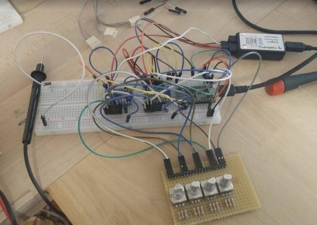

I meanwhile found time to do some experiments with the multiplexed encoders. The setup is a bit messy (need to wait for the boards from china) but works nicely. Schematic, BOM, Gerbers etc here https://github.com/luni64/EncPlex/tree/master/extras
I added a class for the multiplexed encoders to the original library and moved everything to a new repo https://github.com/luni64/EncPlex. I also added callbacks which fire when one of the encoders changes its value this is quite useful for things like controlling menus.
Here a quick example showing how to use the callbacks

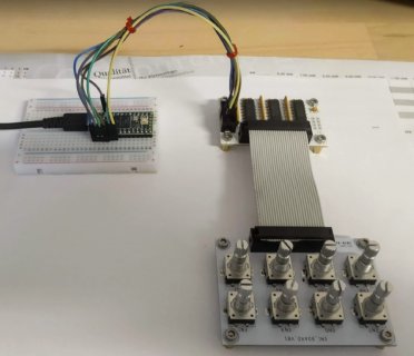

Looks like China is back! Got some test boards yesterday which I ordered a couple of weeks ago.
The multiplexed encoder library described above works nicely with it.

Here a simple example using 8 encoders multiplexed by 74165 shift registers:
#include "Arduino.h"
#include "EncoderTool.h"
using namespace EncoderTool;
constexpr unsigned encoderCount = 8; // number of attached  (daisy chain shift registers for more than 8)
constexpr unsigned QH_A   = 0; //output pin QH of shift register B
constexpr unsigned QH_B   = 1; //output pin QH of shift register A
constexpr unsigned pinLD  = 3; //load pin for all shift registers)
constexpr unsigned pinCLK = 4; //clock pin for all shift registers
                               //74165 datasheet: http://www.ti.com/product/SN74HC165

You did see the schematic and boards I used here: https://github.com/luni64/EncoderTool/tree/master/extras ?
Using a T3.2 and 74HC165s and have several spare 74HCT245 buffers so can power the HC165s from +5v or +3.3v. Ok, the HC165's can work a little faster on +5v so am curious, is there any benefit in running them at +5v for this application?
Since the T3.2 is 5V tolerant you can directly connect the '165s to the Teensy and supply them with 5V. More speed is always good if you need a lot of multiplexed encoders but my experiments with 8 pcs didn't show any problem with a T3.2 so far.

I used the rainy day to brush up the documentation (ongoing), adopted the examples to run with this version and published everything on GitHub: https://github.com/luni64/EncoderTool/releases
Hope this little fun project is of use for anybody.

Set up for 16 encoders although only wired two so far for a test. Only getting response from one encoder. Believe it or not it looks like I have a dodgy brand new encoder. Am using pullups so tested all A and B inputs by prodding with a jumper wire to ground and response is same for all 32 inputs. There are no missing wires or dry solder joints so the conclusion is that the suspect encoder contacts do not seem to close. Bourns 96 ppr no detent. Expect the unexpected.
If your arm can be twisted, my hand is up for rotation speed sensitive value multiplier but for now am more than happy to press on with mechanical details.
Cheers for now.
Good, don't forget to set the count mode to 'CountMode::full ' if you have encoders with no detents. Default is 'quarter'. Will be interesting to see it working with 16 encoders and the 74165. Actually I never tried more than 8. But, I know that the CD4067 works fine with 16 encoders.
Let me know if you have issues I can help with.
Thank you. Had already sussed out the (CountMode::quarterInv) and other library features.
Multiplexed_74165 works as expected so for the learning experimented with 04_Callbacks.
Here, (CountMode::quarterInv) works as expected but (CountMode::full) gives jumpy output. Just flagging at this point. Need to mount a full batch of encoders and think about setting up some tests and snapshot/post the output and a some pics of the hardware.
Will be a few days.
