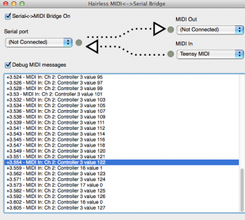

So i am still trying to sort out my multiplexing code for analog inputs using arrays.
Thanks VERY much to Lukas from www.lbsfilm.at for the original code ! GENIUS
My edited Code :
Problems:
1. The pots aren't in numerical order as i've connected them EG: pot1-pot8 to the mux1 (connected to A0)
2. The midi signals are corrupt EG: controllers are getting mixed together like this on controller 3 :
3. Sometimes controller 16 repeatedly sends values without any faders being touched.
Questions:

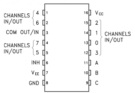

1. What is the correct pin order to connect the pots to the mux's so that they appear as pot1 - controller1, pot2 - controller2 etc ?
this is what i have now:
2. How do i get the correct controller messages to send though usb midi?
3. Are there any code errors that are to blame?
