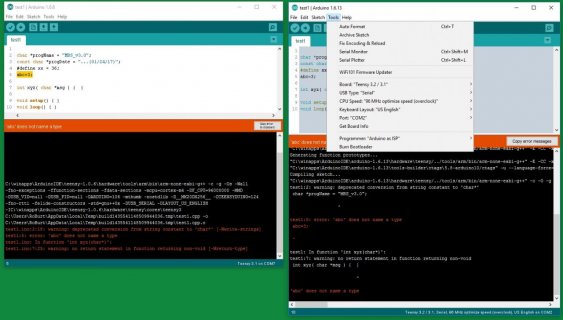

What I would really like to see is the "errors" in the Teensyduino verbose output compile window being shown in a different color from the "warnings". IE, every one of my programs shows dozens if not 100s of the following totally useless warnings, and any actual errors are buried in the pile, and it takes endless amounts of wasted time to find them, starting with blowing the IDE up to fill the entire screen so you can even read the lines. Foo.
warning: deprecated conversion from string constant to 'char*'

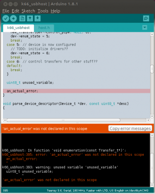

The warnings are supposed to show as white text and the errors as red. Like this:
Can you give me a screenshot of how the errors are warnings are actually appearing on your screen?
Hopefully you could do this with a relatively small program you can post here, and tell me which operating system and software version, so I can try to reproduce the problem here.
The really are supposed to print in different colors, exactly as you have wished. I would like to know why they're not.

Oh darn, this is kind of one of those "never mind" sort of things. I've been using the older Teensyduino install (v1.24 on IDE v1.0.6, left side of attachment) so much with my T3.1 modules that I hadn't noticed things had changed on the newer installs (v1.32a on IDE 1.6.13, right side of attachment). However, there are still some weird things.
The attachment shows the same sketch compiled in each version of Teensyduino. I added some obvious warnings and errors. In the new version, the errors are indeed shown in a different color from the warnings, although the formatting uses a large amount of blank space. And now the warnings are the same color as the compile statements. Strange. I don't know if that's better or not.

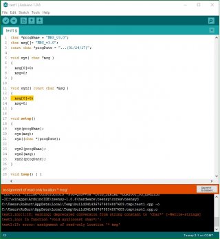

Seems to me there has always been a problem between declaring something as char *x and char x[] with the C language, so sometimes the programmer has to think about what he's doing, ha. Eg, in the following sketch, the compiler has caught the error at line 13, but it compiles fine if line 13 is commented out. OTOH, it seems to me that lines 19,21,23,25 will crash at run time. Deprecation, or no.

The newer compiler versions print the actual line of source code after the error, then a line with a "^" which is meant to point to the exact location on the line where the error occurs, and then a blank line which is probably meant to help you visually see the "^". Maybe?
I'm also not sure if it's better or not.
In an ideal world (with a *lot* more hours in every day) I've considered trying to add GUI elements to Arduino's lower panel. Ideally this ascii art text from the compiler could be replaced with something much better with real graphics. All the extra info could be hidden under a little more/less button that expands the info and highlights the source line in Arduino's editor. Links to "help with this error" could open up (ideally) well written help for the most common causes and suggestions for troubleshooting errors and warnings, and in a really ideal situation such help could get some context cues from the source code to prioritize which help to show first.
But for now, I'm working on EHCI USB, and then a long list of minor issues, and then probably some improvements to Wire, and Ethernet, and improving the website..... seems unlikely such work on the Arduino IDE will happen anytime soon, at least by my hand...
