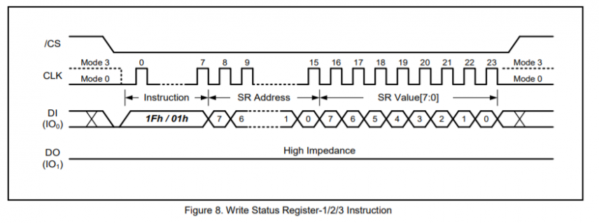

Thanks for posting so I can at least do a verification that i did the soldering correct. Will also help when I try to use FLEXSPI :)
Quick status. Not sure I did this right, probably not or my chip is not on right :) Here is the start of using FLEXSPI with the NAND chip where the FLASH goes:

For a start not sure if I understood the LUT setup correctly but at least with what i have i get something even though its not right :)
Begin Init
Status after Reset (S/B 0):
 FLEXSPI2_RFDR0=00000002  [COLOR="#FF0000"][COLOR="#FF0000"]//IMPLIES WRTIE LATCH ENABLED [/COLOR][/COLOR]
Status 1: 02
Binary: 10
FLASH ID: FLEXSPI2_RFDR0=78F9E4FD
 FD E4 F9 78  //First byte should be a dummy read then EFh, 21h, AAh
at 0x 1000000
FLASH ID2: 78F9E4FD
So if any one gets around to soldering one on or has any comments let me know
Ok it lives after a successful operation :) and some playing with LUTs, Raw Dump:

For write it looks like:
Capture1.PNG Tried something similar but not sure if did it right"
Use PINS1. If you use PIN4, it will transmit on all 4 data pins using only 2 clocks.
