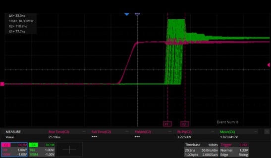

On the image attached "Scope_Traces.png", the pink trace is the input to the Teensy from the square wave generator. This looks correct to me. Then, the green trace is a 10 second persistence graph of the Teensy's output. You can see first, there is some inherent delay from input to output (something I expected). But, the the input-output delay changes from run to run. You can see the persistence graph shows about a 30ns variance on the input-output delay time.

1. Does anyone know why there is variance from run to run? Do you think it is the digital input circuit switching from LOW to HIGH state at a little different times every run?
2. Is there a better way to 'phase lock' to a signal like this? Again, I just want to be able to create a rising edge on the output some precise number of nanoseconds after seeing an input rising edge. I do not care about the absolute timing, just that it is repeatable and in the range of 10-500ns.

Surely I can't be the only person thinking that a teensy isn't the correct way to solve this. A hardware based solution using an FPGA or even a handful of discrete logic gates is going to be far simpler while giving more consistent and reliable timing than trying to do this in firmware on a processor.
Yeah that window is likely too small for a Teensy... The pins are only rated for ~200MHz, and using an interrupt is definitely out of the question when instructions take longer than 1ns.
If I understand what the OP means here, it can be done by with a QTMR, interrupting on input capture and then setting an output compare some number of clocks ahead of the capture value. The output compare match can trigger the output signal high to go high, so the output rising edge would be consistent to 1 clock from the input edge, or better then 10 ns. He doesn't seem to say how often this needs to happen.
Using the Qtimer hardware would probably give the most repeatable result, since it's not affected by CPU issues like bus latency, branch prediction, etc.
But the timers run from the peripheral clock which is 150 MHz, not 600 MHz, so you should set your expectation for at least 6.7ns.
