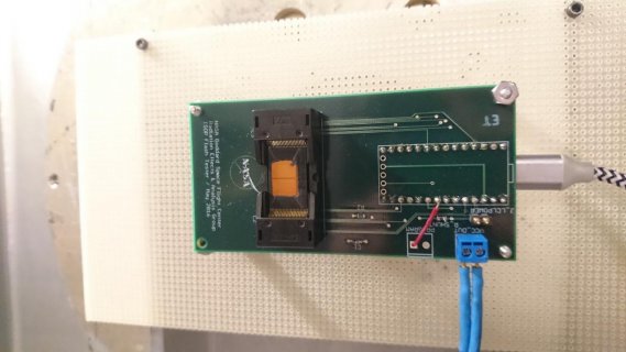

In the early days, testing a relatively simple, socketed, planar NAND flash with Teensy 3.1 at the Lawrence Berkeley National Lab:

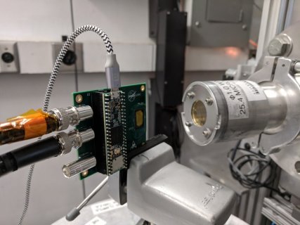

Moving to a T3.6 for one of the first 3D NAND memories, testing it at Texas A&M for an upcoming space telescope mission:

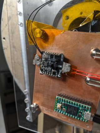

Testing a COTS geomagnetic sensor for a heliophysics mission with Teensy 4.0, using a copper-clad PCB cut in house:

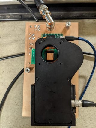

Helping to resolve an in-flight anomaly by again combining rapid prototyping technologies (Teensy 4.0, copper-clad PCB, and 3D printed test fixture to hold an optical shutter repurposed as beam chopper)

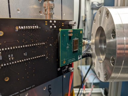

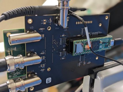

And most recently, an 8 Tb, 96-layer 3D NAND flash for a research program, using a new Teensy 4.1-based test board:
