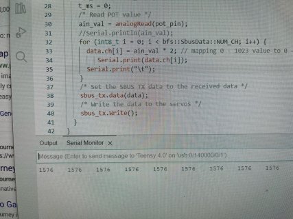

I also tried just giving i an assigned channel value of 1 and leaving data.ch = ain_val * 2; hoping that would work but also to no avail
Disabled the Serial Port communication just to check, no change. I'm messing around with different values and seeing if anything clicks. Also interesting when I declare #define NUM_OF_CHANNEL 8 it does not seem to affect Num_ch later in the sketch as I can print it out
Serial.println(data.NUM_CH);
it still shows a vlaue of 16 instead of 8
Also found a post for an Sbus Arduino Library which is written to control this same gimbal. They are using 7 ms value for their timing, Don't know if that is actually correct or what it would affect but it was interesting to see..
// Sbus delay value
const int sbusWAIT = 7; //frame timing delay in msecs

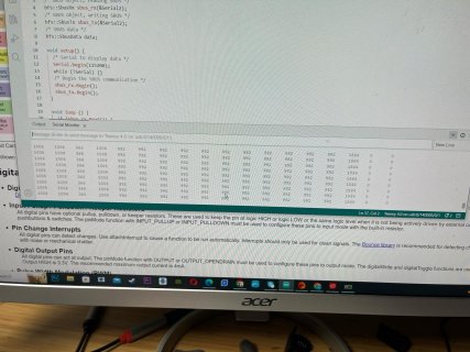

Still Plodding my way through trying to diagnose the issue. Loaded the passthrough sketch again from this link https://github.com/bolderflight/sbus/blob/main/examples/arduino/sbus_example/sbus_example.ino and took a pic of the output from the Serial monitor. The first 4 columns represent channels 1-4 and each changes value individually as the stick axis moves.
For contrast I also set the sketch using pot values to print Serial.print(data.ch); I got this output on the serial monitor. There values do not change with the a change in pot value though the gimbal does still respond moving in all three axis simultaneously.
I would assume that the data.ch printout from the second sketch should be the similar to that of the passthrough sketch.
I would add in a println after the for loop on line 36 so that you get a newline every time that you're going to send an SBUS packet, then the columns will match the channel number.
Ok That worked adding the Println and Serial.print("\t");
I can now see the data,ch value on all channels in separate columns. This should be a big help.
Interestingly if I change value of ms to 7 vs 10 it seem to have no effect. Pot still changes value and seem to affect gimbal in the same way.
Now just need to figure out why I can't get values to individual channels
