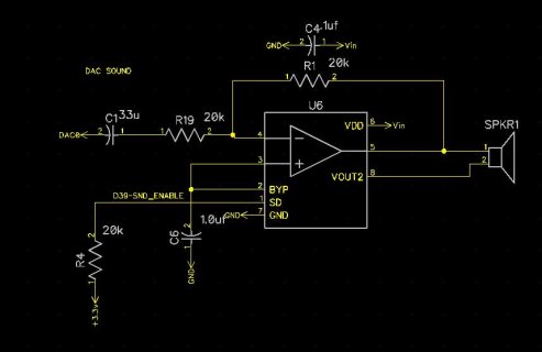

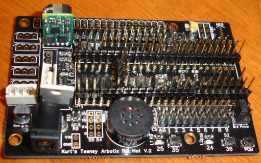

On some of my boards, which are only for my own usage, I use a: LM4862M chip.
Circuit looks like:
I use a small speaker on my boards, which don't give me a lot of sound, but enough for some feedback information:

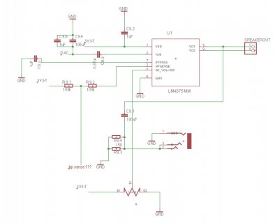

LM386 seems to be a good choice. Though, if space is a critical factor, there could be the need for a smaller package. I made some tests recently and came up with a LM4875MM.
Bildschirmfoto 2017-01-03 um 08.14.18.jpg (using the DAC on a custom Teensy 3.2)
