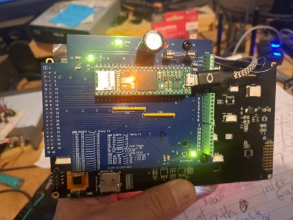

I understand this is a Teensy forum so to be clear these will be connected to a Teensy 4.1 through serial and ONLY use the ESP32-C3 for the WIFI.

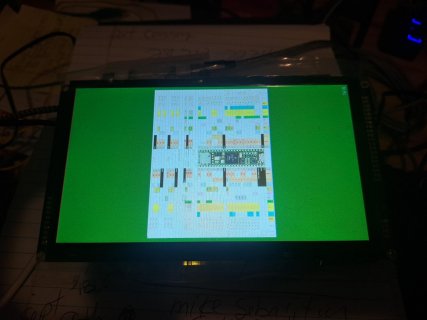

The basic project at this time is to have a clock (7” display run by a Teensy 4.1) that shows time, date, temperatures, and turns on and off some lights. The temperatures and light control will be for 2 different buildings 100’ and 200’ away and will send the readings to the display in the house. I have WIFI router and extenders already in place.
Currently I have the ESP on bread boards and they are powered by the USB port
The Problems…. I don’t understand the WIFI send and receive process.
  • Main problem - I can get the client to send to the server but I CANNOT get the server to send a message to the client.
  • Secondary - The data sent from the client and received at server seems very SLOW at times. The client sends two different codes to the server. The server turns on and off an LED depending on the code received. I am running a millis timer that tracks the LED on to off and off to on times… so basically time from the end of one packet to the end of the next packet. Sometimes it runs below 50ms but other times around 200ms – 400ms. When it runs slow the times are very consistent like there is part of the WIFI driver waiting for something to clear or respond… buffer… ack…
  • I cycle the power on the ESP and it might run below 50ms till the next time I turn it off. Then turn it back on later and it will run slow. I did try two different wireless networks and no change in the pattern. I tried another pair of ESP32’s and the same. Not sure if is the client or the server causing the slowdowns

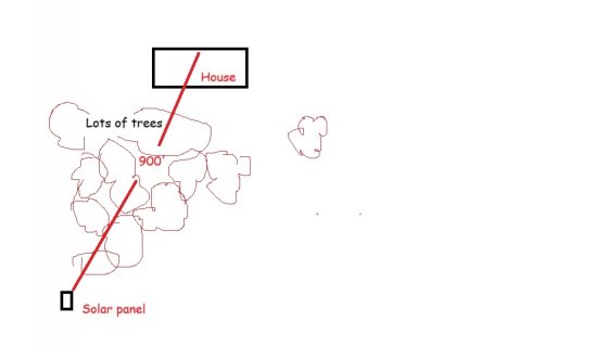

Nice... I have a solar assembly that is 900' away that I would like to monitor the battery and solar voltages from the house... The EBYTE Lora would work for the info and the Library that you and Kris worked on.
I use these things all the time such as my home monitoring system. EBYTE also offers a 30db unit EBYTE E220-90T30D that will give more range. Caution, you cannot power these from the onboard power regulators, you must power them from an external source.
Sorry I got the part number wrong, it should be EBYTE E220-900T22D.
The ..22D is good for up to 5km and the ..30D is good for 10km.
Both those distances are open space, line of sight of course.
But given that your range is only 900' (0.27km) the 5km range of the ...22D should suffice.

Where will your antennas be located?
One will be inside the house but on an outside wall. The other at the solar panel. Both about 6' off the ground. Maybe because of the trees and putting it on the furthest wall from the solar panel unit I should get the 30db... Would I get better over air data rate with more db?
Potentially yes, but there is no point on going overboard.
Note that the lowest Air Data Rate (ADR) is 2.kbps (think of it as 240 char/s) will have the largest range.
You can monitor the rssi value to see how well you are transmitting/receiving and then decide upon upping the ADR.

Bear in mind that with LORA there is NO handshaking. The data just gets sent and it is up to the user to determine if the data is getting through.
In a lot of cases there would be no need to have any handshaking. On the other hand simply sending a simple small ack return message would let the sender know that the data got though ok.

Gone past WiFi now Andy. Using/discussing ESP_NOW on ESP32s and Ebyte Lora modules as being more appropriate.
I see that but I also didn't see any meaningful suggestions on how to make the wifi option work. As with any problem there are lots of possible solutions, it doesn't hurt to offer an alternative approach. If nothing else a standard WiFi method gives a lot more flexibility for future expansion, it allows wired ethernet and other brand devices to all connect if required.

I will be looking at the voltage of the solar panel (0-38VDC) and batteries (0-30 VDC). I will have one decimal accuracy. after the analog read I am using the MultiMap Library to "map" my actual voltage readings. However when I make the array for voltage readings I multiple by 100 so I don't have a decimal then before I display it I can convert it to the float
