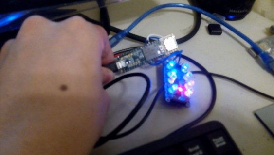

I'm a hobbyist in Taiwan , my project is trying to make POV props (with as many pixels as possible) for flow art
here's a quick data flow : micro SD - > (MCU)teensy 3.5 -> LED driver -> next picture cycle
My POV project uses from teensy 3.2 or 3.5
reads pictures (.bmp) with time settings (.txt) from SD card (via SdFat/ SDIO)
and send the data to LED arrays
I uses dotstars (apa102) for last few months,
and now decides to make my own LED array for higher density LED layout.
So I started on modifying the example/library from Adafruit TLC5947 tutorial, with their TLC5947 breakout hardware
https://learn.adafruit.com/tlc5947-tlc59711-pwm-led-driver-breakout/overview
the modified example tlc5947test.ino worked fine , with hardware connects
clock to teensy pin 13, data to 11, oe(blank) to 15 and latch to 10
and a external Lipo battery for the tlc5947 breakout , in case the USB power couldn't afford the LEDs.
-> I'm using arduino IDE v1.80 with teensyduino v1.34
as I later planned to use hardware SPI, the pins were same to CS, MOSI & SCK
and from the Adafruit_TLC5947.cpp and the TLC5947 schematics,
I guess the TLC5947 driver chip reads 12 bit a channel (a color), and 24 channel per driver chip,
that makes 8 pixels(3 channel per RGB-LED) per driver chip.
I found the refreshing rate is slow (~1Mhz tested)
changing digitalWrite to digitalWriteFast speeds up a lot, but not enough,(~3Mhz)
I use dotstar LED strips with FASTLED library,
with SPI pins used, it refreshes much faster than not SPI pins
and from the Adafruit_TLC5947.cpp, i didn't see it use SPI.
I think maybe I should use SPI port? so I tried to build a SPI version.
My question finnaly starts here: my SPI version isn't working properly.
while the software bit-bang version above works with the same pin connections.
tested on teensy 3.2/3.5 ,they both work with example
but both don't with the SPI version
SPI Version::
I added a function in "Adafruit_TLC5947.cpp" to return LED data in int, for byte recombination
and a line under class "Adafruit_TLC5947.h"
and from the tlc5947test.ino code above,
I replace function tlc.write() to SPIwrite() , include "SPI.h" ,
some serial.print and whatever needed,
the last function using SPI is at the bottom of the code
the code results in LEDs stuck in random situation, unchanging,
I'm not familiar with hardware SPI and not sure what is going wrong....need some guidance,
Thanks, Thanks for helping,
this could be the last software problem (since the SDIO works properly and fast) I encounter
at least, before I start doing PCB layouts
SPI Version::
uint16_t Adafruit_TLC5947::getCHAN(uint16_t channel) {
if (channel > 24*numdrivers) return 0;
return pwmbuffer[channel];
uint16_t getCHAN(uint16_t channel);

void SPIwrite() {
#define TSPEED 4000000 //4Mhz
unsigned int chan1 = 0;
unsigned int chan2 = 0;
byte address1 = 0;
byte address2 = 0;
byte address3 = 0;
// packing each 2 channel (12bit*2) to 3 byte (8bit*3) for transfering
SPI.beginTransaction(SPISettings(TSPEED , MSBFIRST, SPI_MODE0));
digitalWriteFast(latch, LOW);
for (unsigned int ledpos = (24 / 2) * NUM_TLC5974 - 1; ledpos > 0; ledpos--) {
chan1 = tlc.getCHAN(ledpos);
chan2 = tlc.getCHAN(ledpos - 1);
address1 = (byte)(chan1 >> 4) ;
address2 = (byte)((chan1 << 4) & (B11110000)) + (byte)((chan2 >> 8) & (B00001111));
address3 = (byte)chan2;
SPI.transfer(address1);
SPI.transfer(address2);
SPI.transfer(address3);
SPI.endTransaction();
digitalWriteFast(latch, HIGH);
