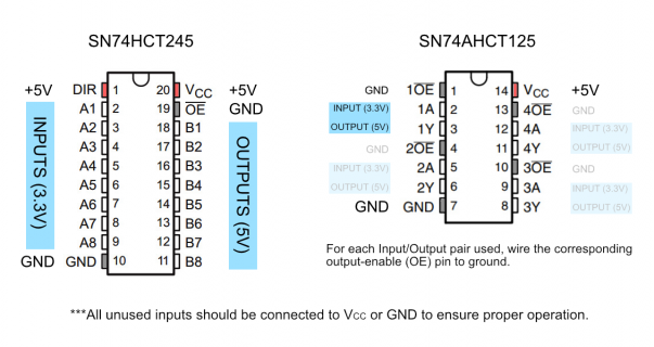

Hi everyone! I am new to using a teensy 4.1, I am familiar to the arduino and esp32. I am building a 6dof robotic arm and using normal stepper motors and limit switches.
I am using sn74hct245n level shifter for the signals and it is working fine. But I am having trouble to get the robot to home. When the motor hits the limit switch it does not stop but rather slow down and just go through the limit switch and then go go to normal speed.
I wired the limit as NC, I took the COM pin and wired it to the GND of the teensy and the NC pin I wired it to the teensy pin to track the state. When I tested the limit switch by hand, it worked fine. I am following the pinout provided on the left of the photo for the level shifter. And for the signals I wired the +5v pins all to the power supply +5v and took the -signal pins to the teensy.
I am using plateformIO and arduino framework for the teensy, and using fastAccelStepper Library to control the stepper.

It might help if we could see your code.
When you paste it (the code) use the </> button, which ensures that code formatting is maintained.

I tried a test to see the live state when the motor is moving, I noticed that the state is clear when the switch is engaged but when it is engaged the state is changing very fast between 1 and 0. So the signal is not clear, I think this is what is causing the slow movement when the stepper touches the limit switch. Here is the code:

Internal pullups are very weak - try external 1k pullup resistors on the limit switches so they are more immune to noise from the motors and motor supply wiring?
