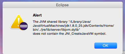

I've tried to install Eclipse and I get an error that my JVM is not recent enough (i.e. 1.6.x vs. the 1.7 that's required). Curiously, I just updated my Java to the latest build and thought that would take care of the issue, but no such luck. Is the JVM a separate download? FWIW, I'm running Yosemite.

Ok, so I noodled my way through getting the older version of Java uninstalled and the new version downloaded and enabled. FWIW, it would be helpful to mention in your instructions that the JDK version of Java is required, not just the 'regular' Java download (this may be obvious to you, it wasn't to me).
Now the JRE is at version 1.8.x but the 32bit version of Eclipse still won't launch.
Eclipse 64bit does launch but it won't find the plugin as described in step 7 of the installation instructions.
I later found the Arduino-bundled version of Eclipse and that didn't work either. It wouldn't accept Arduino 1.5.8 as valid and 1.05 was rejected on the basis that this was v2.3 of the plugin.
This has been a somewhat frustrating experience! :D
I think I'm going back to BBEdit and the Arduino IDE. Devil you know, and all that.
