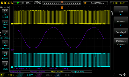

The iMxRT1062 used in Teensy 4.x was designed by NXP to perform scalar or vector motor control.
I published the Arduino eFlexPwm library allowing to use all the features of NXP eFlexPwm timers to control motors or inverters.
It is still possible to use analogWrite() on timers that are not used by the library.
This library is available in the library managers Arduino and Platformio.
The code is published on GitHub, it is still in beta version, but the work is progressing well.
Here, for example, is the result of the generation of a sine for the control of a single-phase inverter :
and the corresponding code
I am currently working on the control of a three-phase motor.
Hope this is useful to you.
Wow, this is very nice. There have been some threads regarding generation of center-aligned and complementary PWM, but nothing like this. Did you create this from scratch?
If you look at the code you will see that I rely on the NXP driver code, the NXP part is in C language, it is separated from my code in the src/nxp folder
The goal of my work is to make all the power of eFlexPwm accessible to Arduino programmers with a "simple" use.

@epsilonrt, I got your latest version 1.2.5 today, and finally got around to running your test programs and looking at signals. Everything worked as you described (very good comments). I need to do some reading to understand the overflow interrupt and duty cycle update.
Just FYI, SinglePhaseInverter has the code shown below. Did you mean to delete the first clause with Tm2.begin()?

Thanks @Joepasquariello, indeed the first clause should be deleted.
I correct on the github repository.
The latest version is 0.2.5, I will switch to version 1 when I have carried out all the tests exhaustively.
Currently I'm working on an educational version of VFD for a 3 phase asynchronous motor and so far everything is working as expected.
