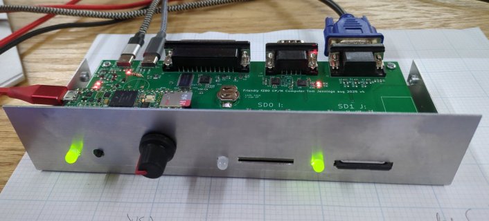

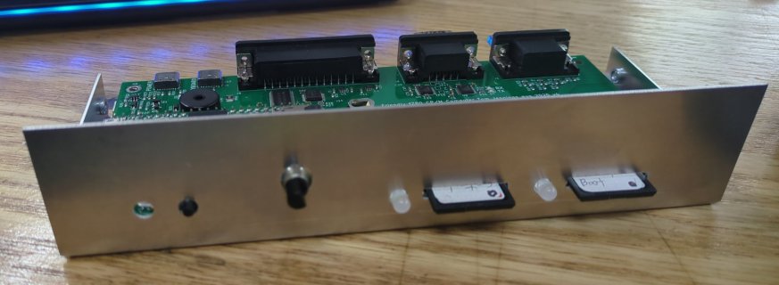

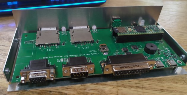

I've got MP/M reliable now; I'm working on the cabinet and (printed) manual. MP/M forced some redesigns, as expected, but it's all fairly seamless now.

Here is a couple of pictures:
Sorry, a little blurryo_O

I did a board revision, added tristate drivers to the SD card data-outputs (in case they were dragging their feet) on the two removable cards. The error rate on read-only plummeted to almost acceptable (one error per half million); mixed read/write hardly improved if at all.

I'm having nice aluminum cabinets made. Here's the base part, making those first, the top will be next (next week I hope). The tops will be painted. I'll send you one. Favor any particular color? (I use Montana paints, the tagger/graffiti choice, great colors; pick one!)

Those cabinets will be nice. Mat black? Sounds like you are getting close to the finish line. You are being very generous😀 can't wait to play with MP/M ||. I have never messed with it before...

Sure you want flat black? I use Montana paints, the graffiti folk use them. Amazing colors. Here's the choice, lol.
I've been thinking something bright, and period-incorrect. Vivid red, Kalani orange, Electra violet, Valley green... I'll want to pick one or two colors for the dozen, but I also have some colors laying around: black, white, Bozai green (looks "surplus"), Kalani orange. Lol flat black works.
The top cover will be painted, the base aluminum with a clear coat. Rubber feet on bottom not shown here.
